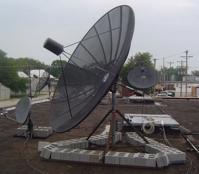

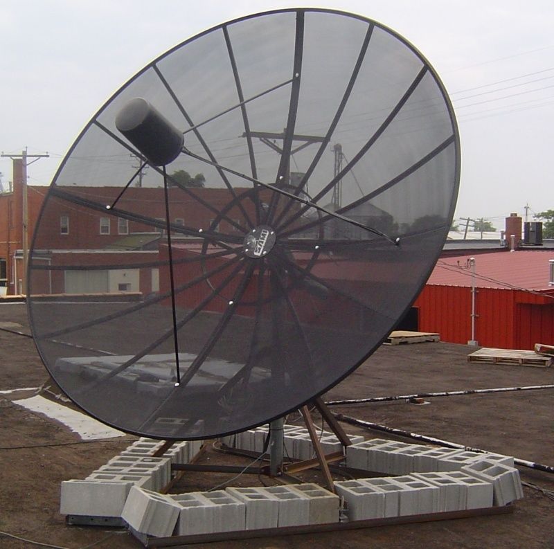

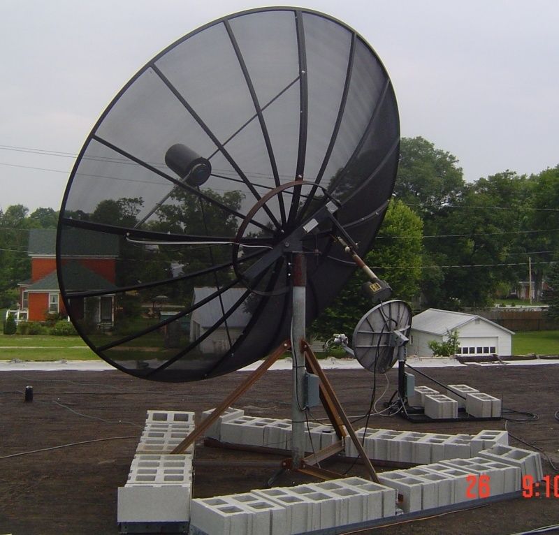

I finished the fourth C-Band dish on my roof yesterday to be used by the family with the DSR-922 that I got a few weeks ago.
This is the 10 foot SAMI dish that I purchased a few months ago for $50.00. I repainted the panels, and put all new bolts in. It went together perfectly and a perfect string test off the ring, and after mounting on the ring.
I actually built this mount my self. Went to a steel place in my hometown about an hour North of here. (Got to go back up there. I found another 1 Meter Primestar ripe for the taking.)
I had the layout, took the measurements, and went out to where I used to work ten years ago, and borrowed their demo room, cut-off saw and welder. Between me and the store manager, we welded it up. The center mast was already welded up by my friend the welder a while back. (He knows me pretty well ) Took it to another friend who has a drill press for drilling the holes. If you look closely, I put adjustable bolts on the outriggers to make leveling easier rather than using washers like on the other three.
It is another outstanding dish, and gets great reception of both C and Ku.
Here are some pics:
