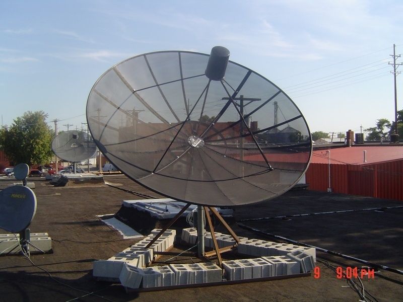

We had a little cool front pass through on Thursday evening which let it cool down to about 70 yesterday morning early so I had a chance to do some fine tuning on the SAMI dish.
BTW, I sold the 922 to a member of another forum, and bought a 920 from George.
I have it hooked up, and it and the dish are doing a fantastic job.
It just needs a little further fine tuning for Ku, but that will have to wait for a whole day of much cooler weather. :D
I am using my DMSI BSC-211 13K C-Band LNB, and I finally broke down yesterday and bought a new Eagle Aspen .6 DB Ku LNB after experimenting with several Ku LNBs that I had on hand, and that George had sent me to test. The C-Band signal/quality is outstanding, and the Ku is about 95% of what it should be.
As I said, when I get some cooler days, I will do some further fine tuning on the Ku, and probably slave the Pansat to the 920 for that purpose.

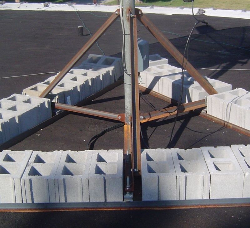

I took a couple of extra pics while I was up there. The original ones at the beginning of this thread were taken on a very cloudy day.
I included a close up of the mount levelers made out of 1/2" all threads with nuts for raising and lowering the center mast.
The family is very happy with the setup and that makes me happy. :)
