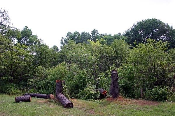

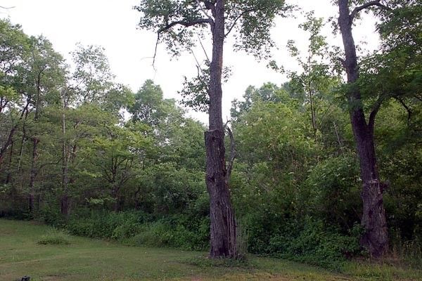

First pic is before CS (chainsaw) and 2nd is the new view of the arc. Still cleaning up the area. :)
