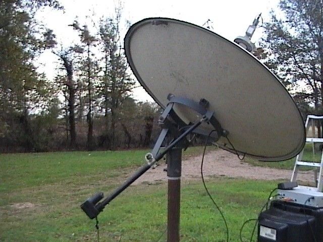

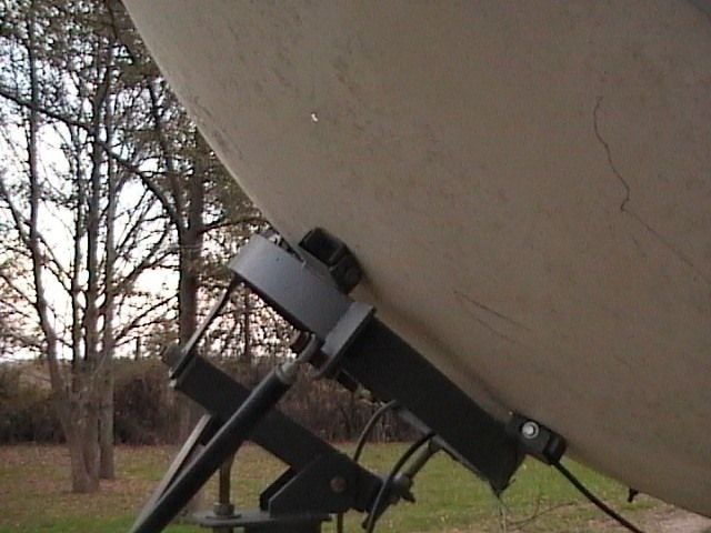

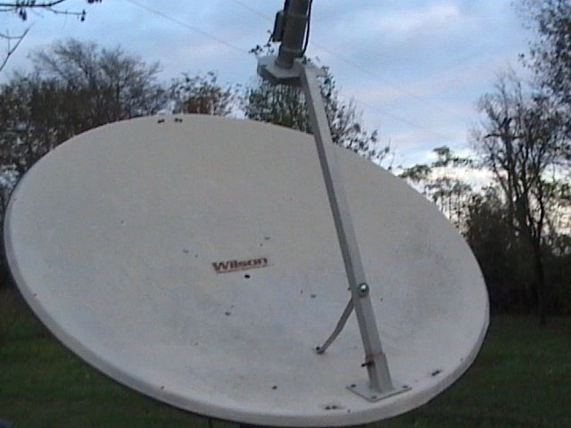

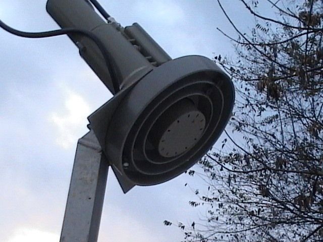

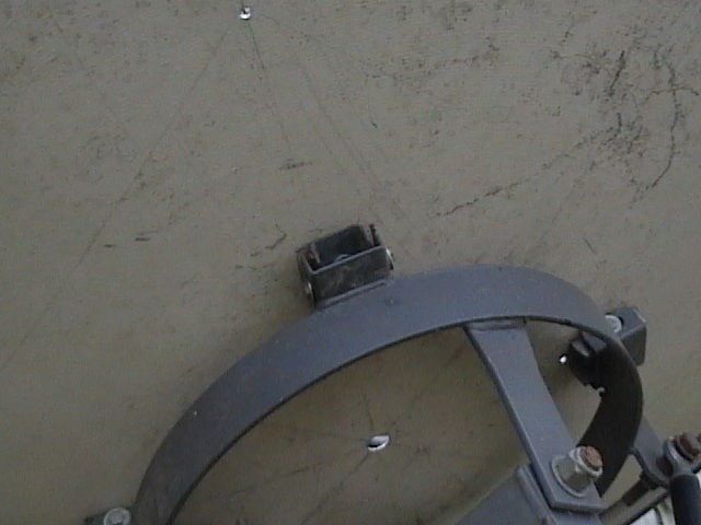

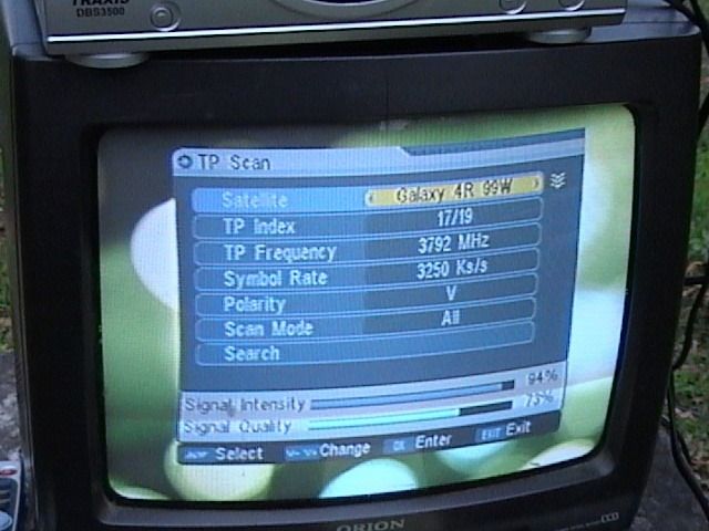

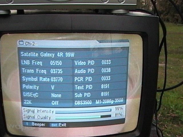

For several weeks I have been working on my first mini bud using my 5 foot Wilson dish, the mount that use to hold a 7.5 mesh dish that was damaged, and BSC 621-2 LNBF. The Wilson dish was one of those dish that use to set on the ground supported by a O ring that held it up.
I worked on this project between rainy weather during October. I adapted the mount onto the Wilson dish, planted the pole, and mounted the dish to it. I spent a few days setting the elevation\declination angles and finding the true south. It was successful. I used my US Electronics ORB5000 to track the Clark Belt arc with great results. :)

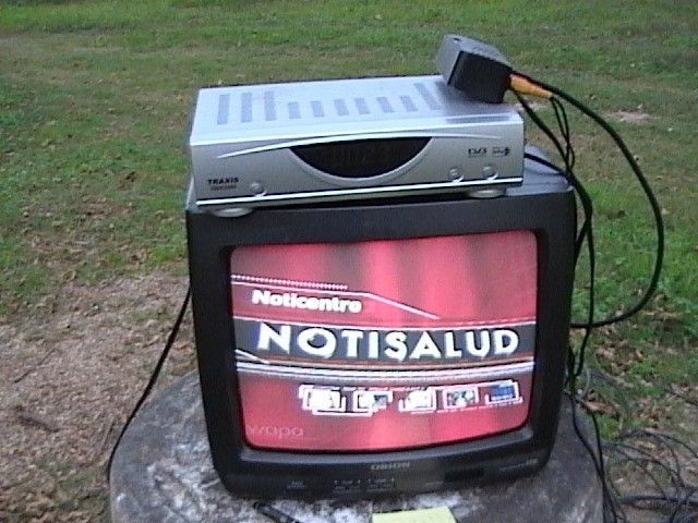

I used my Traxis 3500 receiver to blindscan the C Band TPs and as you can see in one of my pictures I got great signal and quality signals. I tracked a coupla other sats and got good results. :)
At this point, I am only on G16. I will watch these channels until I can buy a cable that has the motor/sensor wires to move my dish. I had a section of the all in one ribbon cable but it has places on it that makes me uneasy to use.
No body around here sell any cable that has the motor/sensor wires so I am hoping to find some somewhere. I just got a RG-6 cable from the dish to my recei er.
I am hoping to use my Coolsat 8000 to run the V-Box and have the Quali piggy backed. I want both HD and 4:2:2 signals. I have been reading about the negative reviews about the V-Box. If that is the case, I have to depend on either the ORB 5000 or 4DTV receiver to move the dish.
I sure hope all this work...
Any suggestions will be welcomed...

very cool :)
a 5 footer I wouldnt consider a "mini-bud"....its on the small side but should still work for most signals up there :)
Excellent project, interesting dish, I've never seen one like it.
Is that the original arm for the feed?
For the cable you could use lawn sprinkler cable, available in various conductor gauges and numbers of wires. Available by the foot at home centers.
A very unusual and attractive looking dish.
Where would one find such a dish... where were they used and when?
Is it aluminum or steel?
You did an excellent job of mating the mount & dish - looks factory! - :cool:
I did a double-take upon seeing that LNB support arm.

Thanks guys! Yes, that is the original LNB arm on that dish. I bought this dish from a lady who moved to a home in town and that dish was lending against the back of the shed. I never seen a dish setup like this before. It has been under my carport for nearly two years so I had been racking my brains out all that time on using this thing.

Iceberg, this dish measures 4 1/2 foot!
Last night I got both C Band AND Ku Band Tps (wasn't much on Ku on G16, tho.). Wish I can use the 621-2 LNB on my 4DTV...

I didn't want the RG-6 cable hanging outside the arm so I drilled a hole thru the bottom of the dish so it can be routed inside the arm.
Yes, Anole, the dish is aluminum! It still has a ring still attached to the outer diameter edge, I guess for strength. Also on the very edge is a rubber trim. It is a impressive dish.

It was produced by Wilson Microwave, don't know if they're still around in any capacity or not. Back then, there were lots of dealers for c-band equipment, and plenty of companies making the parts, and importing some of them. I bought mine from a local discount tv-appliance store.
Most of the dishes available at the time were still those big fiberglass monsters, mesh dishes were just coming into play, and this "Little Wil" system was sold as a hobbyist kit, a way to get a taste of satellite tv without a huge investment or giant dish. They really did the trick on me! And it does a pretty good job on c-band, I was amazed at how well it worked once I motorized it.
