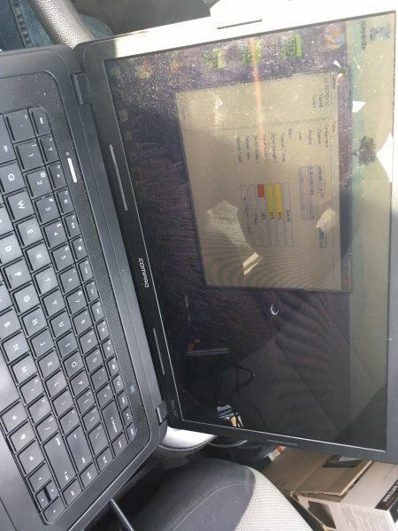

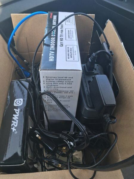

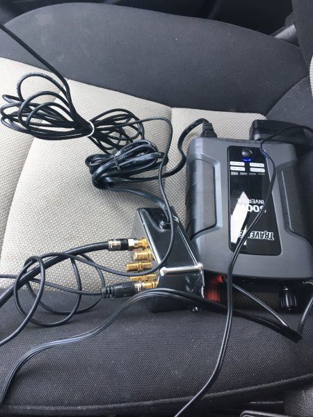

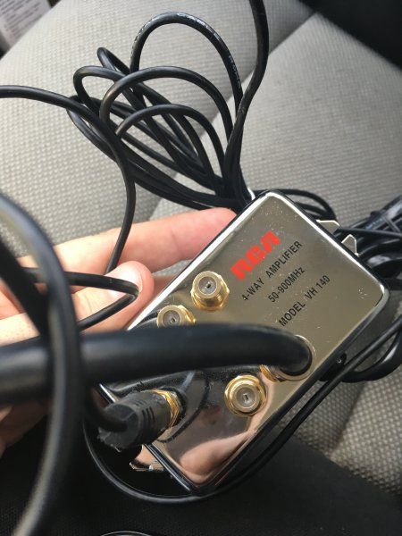

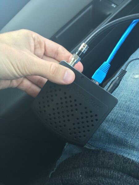

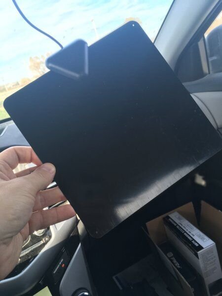

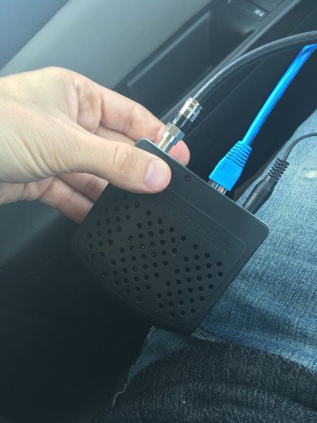

I decided I wanted to take my OTA on the road and see what I could pick up in different towns. So, I purchased a few cheap items and set it up this morning. Had surprisingly good results. Here's my setup:
El cheap-o TV antenna from Dollar General, $12
10db RCA amplifier/splitter $7 new from Ebay
500 watt power inverter with two 120v AC outlets, $3 new from Ebay
a used SiliconDust HDHR3-US, $49 from Ebay
Some cables and my PC laptop.
I was able to pick up quite a few UHF stations from a 40+ mile radius with just the antenna sitting on top of the dash in my car. When I set it on top of the car or held it up high, I got even more.
Here are some photos.

It's a lot like my own setup. My laptop, plus:
Inverter
Router
HDHR2-US
Kitztech amp
Digitenna DUV-VII Antenna (or VHF bowtie, or Silver Sensor, whichever)
I use it to collect TSReader data for stations in places I travel to.
