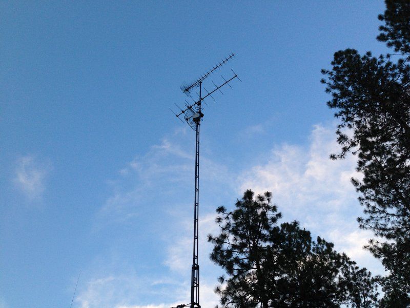

I also live in a marginal signal area. With a minimal insertion loss of 3dB, diplexers cannot be used on my system. Even with an inline preamp, I lost most channels when diplexers were used. Tested with several different models and found them to provide similar performance. Just didn't have adequate signal strength on all but a few channels. Even with only a preamp and dedicated coax run to a single TV, many channels were lost compared to what I could receive at the top of the tower during installation.

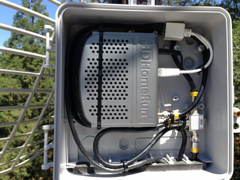

Removed all distribution losses by installing a utility box just below the rotor at the top of the tower and placing a Silicondust Homerun unit with a preamp. Now everything comes into the house on Cat6 and tuned with the HTPC, media boxes and also available to mobile devices via WiFi.

I Removed all distribution losses by installing a utility box just below the rotor at the top of the tower and placing a Silicondust Homerun unit with a preamp. Now everything comes into the house on Cat6 and tuned with the HTPC, media boxes and also available to mobile devices via WiFi.
Those look really cool and I was unaware of them. So I am glad I asked about this issue. That puts another spin on all this tv stuff.

Use a POE over cat6 to power the Silicondust and power the preamp with a transformer located in a utility box at the base of the tower. Also run a 1/2 mile point to point Ubiquiti WiFi to my office and can watch TV from home or watch C-band satellite from the office! :)
