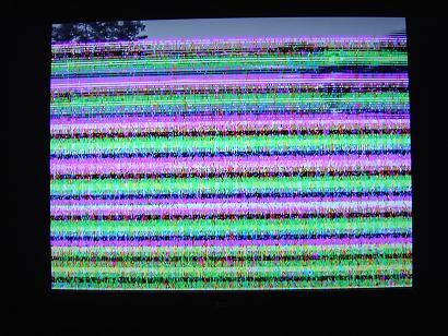

My Pansat 9200HD is worse than ever with the latest '1226' firmware and DVB-S2 Plus tuner module installed. As we have discussed in other threads the issues concerning this abomination of a satellite receiver, it does have it's positive attributes.
In recent email exchanges with Pansat USA's Customer Service Rep Mr. Hugo Montenegro, he explains that a larger dish is necessary for the proper function of this receiver with the new DVB-S2 Plus tuner module. I do agree that it may not work as well with smaller C-band dishes so I have installed a 10.5 ft dish that has no increase on the performance. In fact my 8 ft solid BUD works better in spite of what they say. At this point, all of the problems I've been experiencing are not associated with DVB-S2 signals yet Mr. Hugo Montenegro insists it's a dish size problem.
I'm not having any DVB-S2 signal problems to emphasize, there are other issues concerning the PVR function, the time setting modes and the PVR timer settings and DVB-S problems that I have itemized to Mr. Montenegro. I wrote to him 2 days ago again explaining these other issues and he replies with the same response of it being a dish size problem. Well, I gather the fact that he must not have read my email thoroughly as he did not even mention the PVR and timer issues. I wrote back asking him to read my message again and still awaiting his reply.
The PVR functionality is worse than ever, the option to set the clock manually is disabled, no way to set it up in 'User mode' and the PVR recording timer is useless if I can't set the clock to my time because time varies with individual TP's and not to mention the other malfunctions of the timer.
When watching any channel either it be DVB-S or DVB-S2 signals I occasionally get a "No Signal" pop-up message in spite of an uninterrupted and a perfect audio/video with any quality signal regardless if it's 70% or 99%, it doesn't matter, I watch more SD channels than HD. This doesn't occur with other receivers tested on the same line feed. Since all the new problems I've experienced with the new DVB-S2 Plus tuner module and the '1226' firmware, I've hardly used this stb for any recordings due to the frequent malfunctions. I find it necessary to frequently reboot the stb with a full power-off cycle to hopefully clear any congestion in memory prior to any recordings and/or playback.
To my surprize, I successfully recorded a recent movie on FMC without any glitches. Later that day after rebooting the stb and giving it a few minutes to stabilize I started the playback and within 2 minutes the stb froze up with the video image that I have posted in the photo, this has occured more than once. It was necessary to power off the stb as it was not responding to any local or remote commands. I restarted the playback and this time it played successfully. At this point I consider this box to be unpredictable and unreliable for any usage especially for PVR recordings and playback.

I'm sorry to read your 9200HD is causing so much trouble. I have had only minor issues with my unit since acquiring it not quite two years ago. I do not use the PVR features, however. I started with the original DVB-S2 board and found it nearly useless, but the replacement Plus board has worked perfectly for me. My only quibbles with the 9200HD are:
1. Lack of DVB-S sensitivity compared to other tuners
2. Occasional freezes (once or twice a month)
3. Klutzy GUI
4. Overvoltage supplying vertical polarization (I fixed this)
All of these are merely annoyances to me and may simply reflect my belief that the unit could have been executed better. This is hardly unique to most things in my life. I don't know whether your problems are caused by a different usage pattern than mine, but you may simply have a defective unit.

I have the S2+ bd installed but most viewing is SD. I deleted unused/ unwatched channels and transponders and my freezing ( identical screen as yours ) has improved drastically. It will only very rarely freeze while watching a channel. Before the clean-up, I was about to put it on craigslist, or the trash. Now, freezes are usually caused by me being too button happy.

I popped the unit open and found the regulator that supplies +13V for vertical polarization selection. From memory, it's located near the back of the primary circuit board, not too far from the DVB-S IF input. I also recall that this was a LM317, which is a variable regulator set by a resistive divider. I simply calculated the resistance required to parallel what was already there and come out with the right ratio. It seems Pansat set this a little on the hot side, or perhaps they had a manufacturing issue.
