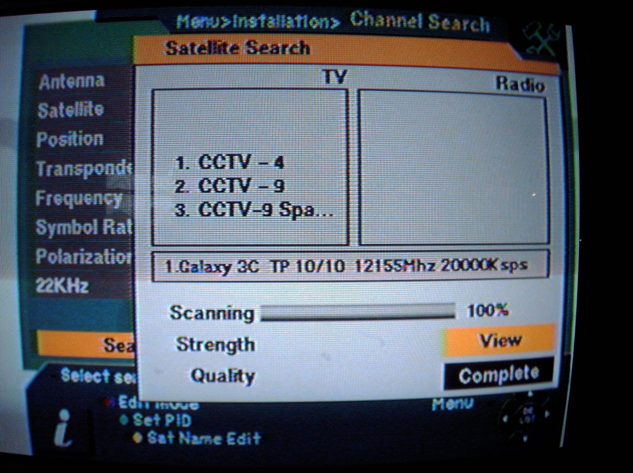

The rain forced me inside and I start looking at my cables - I discovered a bad cable from the wall to the receiver. Once the cable was changed a very interesting observation: the strength for each satellite was different with only IA-5 and Galaxy 3 having high strength and all others bellow 40 - might mean nothing but it is a change! :)

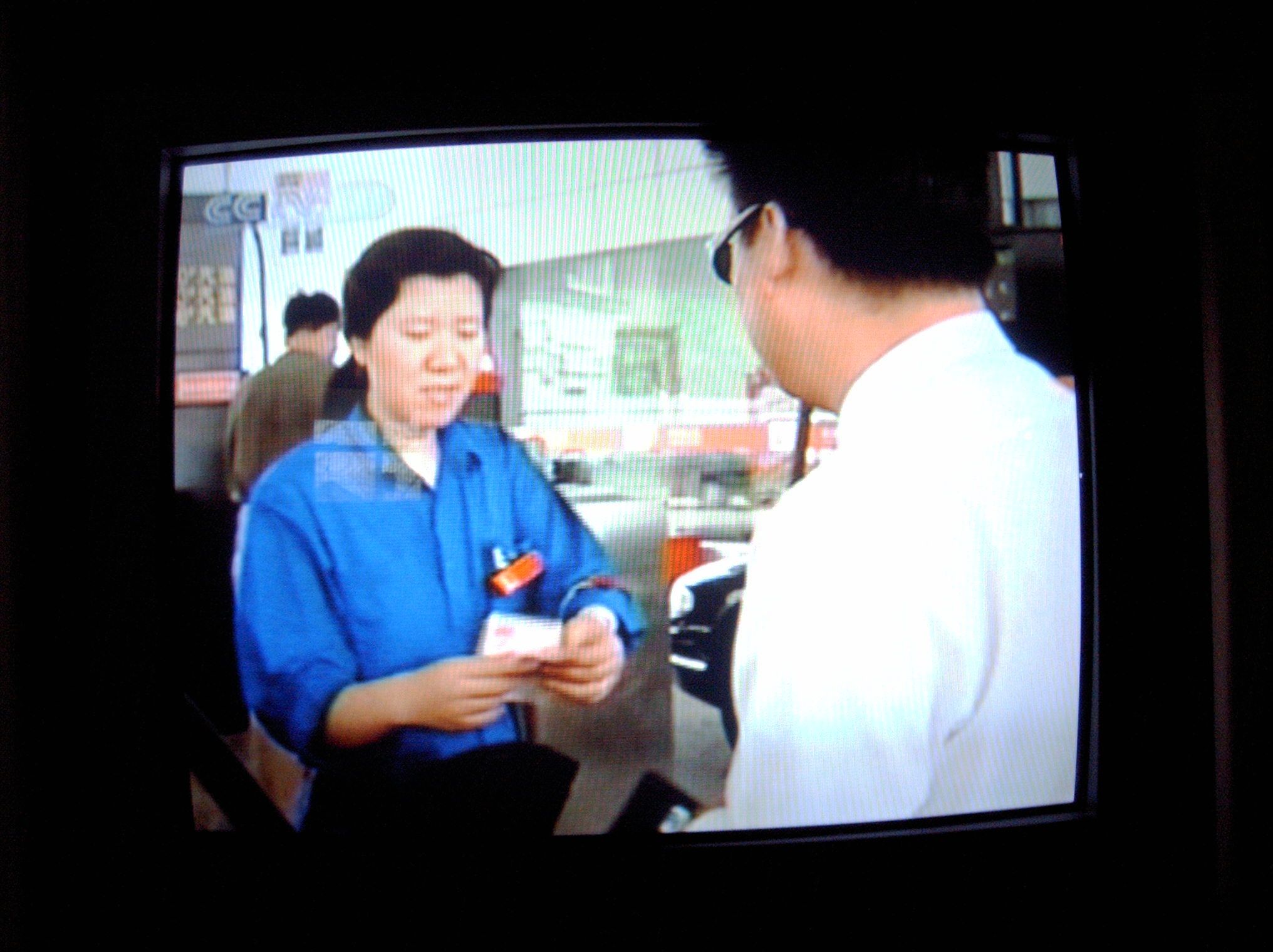

SUCCESS!!!!!
Check the pictures! Now I am afraid to move it!!!

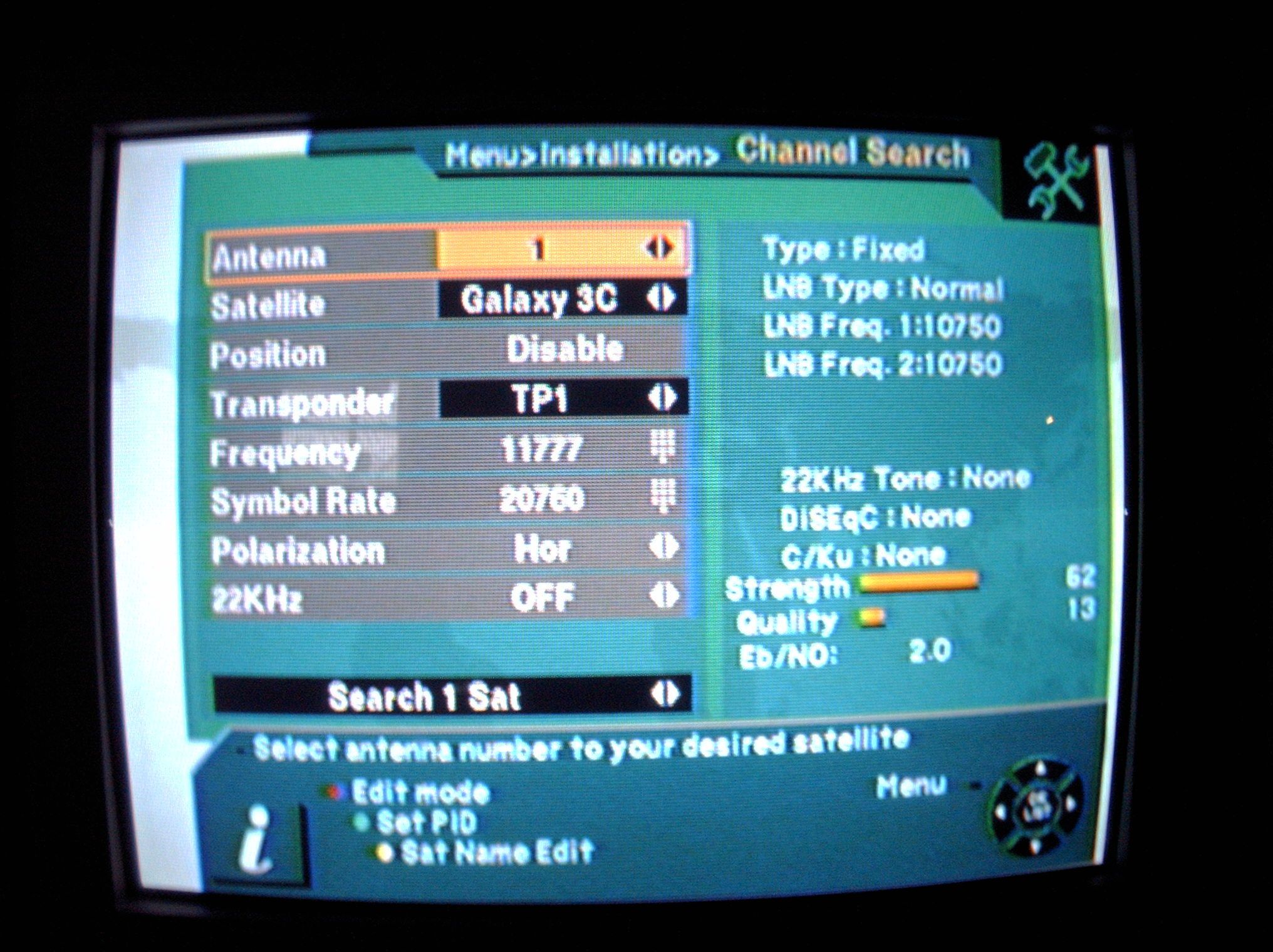

Help on finding the rest and also my Quality is about 14 (pays between 13 and 16) is that the best it can get? By the way there is a cloud cover today.
I got 31 Channels but what I see is CCTV E&F, CCTV-9, and CCTV-4. The rest are encrypted I believe.
Thank you Pete and Ice!
It was a problem with my cables both the one from the LNB to the motor and the one from the wall to the receiver - what are the chances??
How can I fine tune it?
John :) :) :)

WOO HOO!
Yes, the only 3 are the CCTV's. The rest is Racetrack TV (Horse Racing) and those are scrambled.
You might want to try to move it a little bit.....do this
It sounds like you are at the right azimuth, but the elevation is a little off.
The quality should be almost max and the ebno # (the number below it) I have around 7.5 or higher.
I would try to move the elevation every so slightly (like 1/16" of an inch) to see if it helps. Since you arent moving the azimuth (left/right) if it goes away, you can move it back.
Moved it a bit Quality 30 and Eb/NO: 4.5
I would keep trying to see how much it improves.....the only other thing might be left right (and I'm real scared about that.....
this sounds weird, but sometimes undo one of the elevation nuts and try to lean into it to see if that changes. I've done that and its worked.
