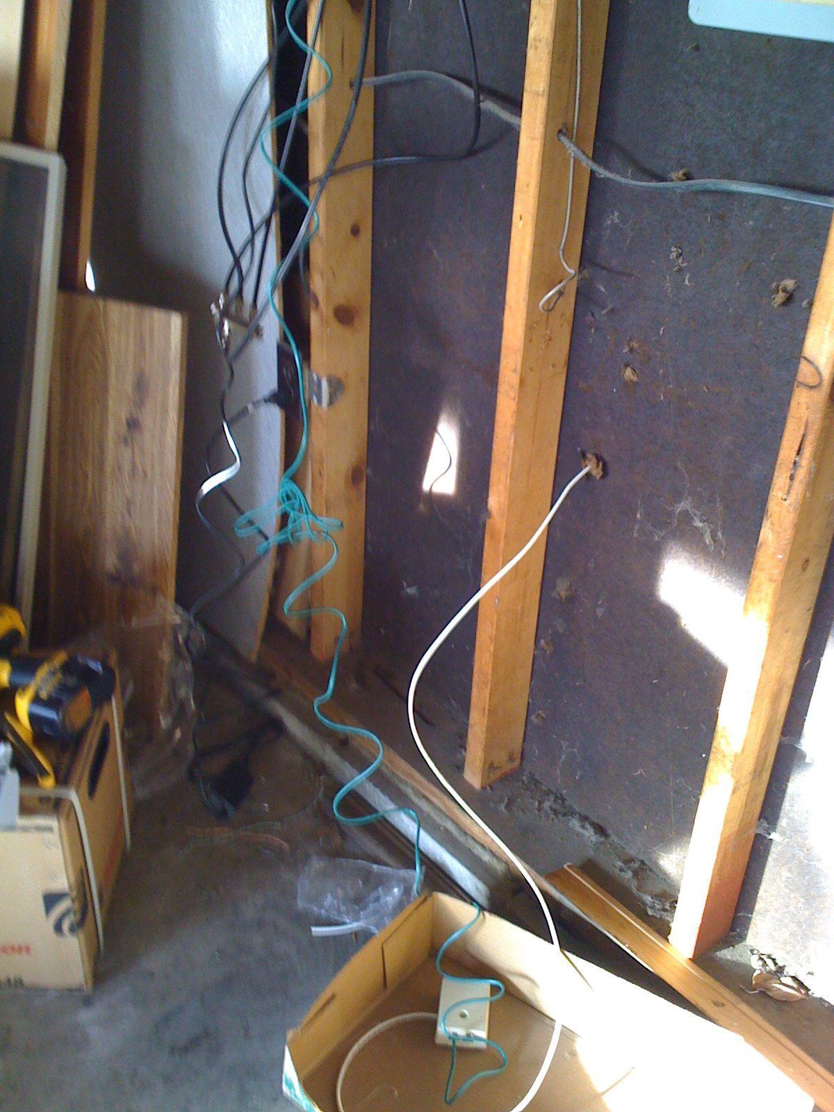

He began working on the NID looking for the pair from the VRAD to the house. At first he wasn't able to get a sync, and put a trouble ticket in. It ended up being that the pair was reversed and he was able to achieve sync about an hour later. In the mean time Three other techs showed up at the residence as it was about 430pm and they were coming off of their jobs. I was glad to see this kind of tag team action going on. By this time the Original tech had began wiring and had three of the holes drilled and ready to be fished with lines ran.

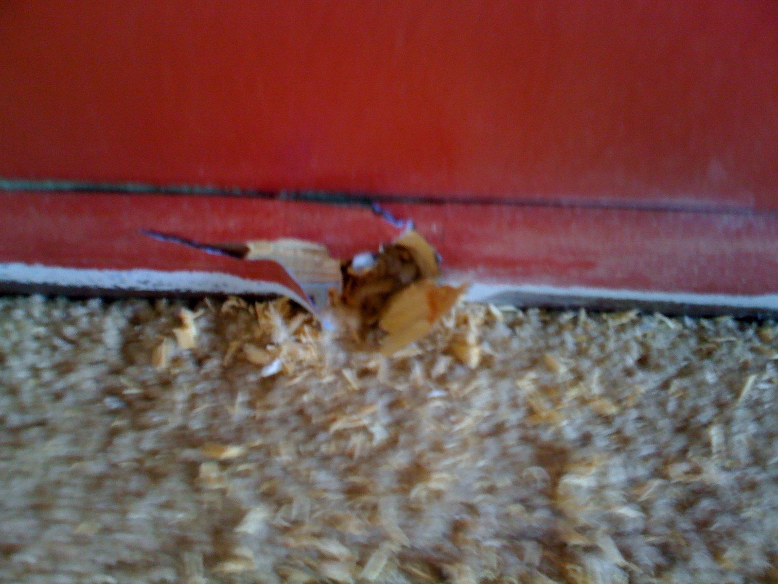

We pulled the rg6 through my daughters room and the living room (I was helping) and got that all set. The other techs were working on the nid and getting that all straight. We finally got to my room and cut the whole for the final line and it turned out that the tech cut the hole one stud left from where the wire was and we were going to have to re drill. He sent one of the other techs down to re drill the wire, when he drilled into the wrong spot and missed the wall by two inches. Instead the drill went up through the living room's trim (damage claim)
IT was about 6pm by the time this happened. They re drilled the hole appropriately this time in the right spot, and we finished that wall fish. When the tech was asked why he wasn't using a flex bit to do the wall fishes wich would have prevented the damage claim and made the wall fishes go alot quicker, He simpley said that att would not give them flex bits or the tools needed to do it. None of the techs on site had a flex bit. There were other tools that they could have used to help make the job easyer, but they didnt have.

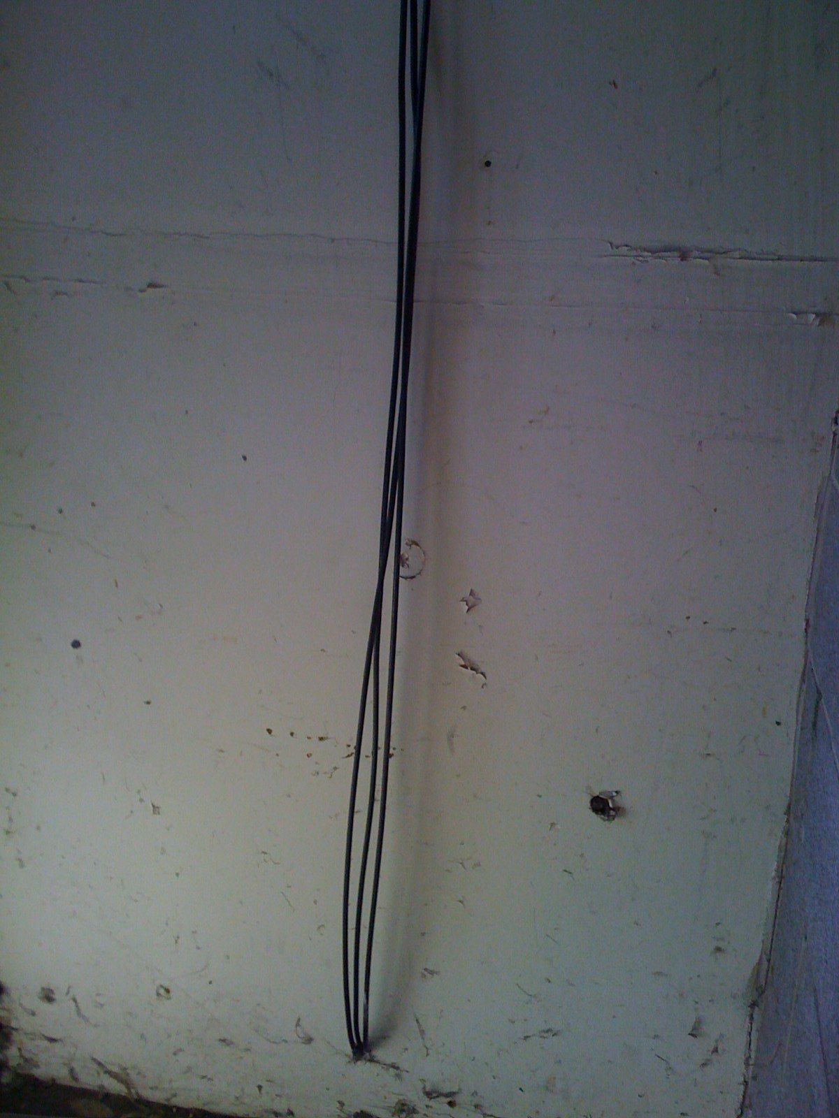

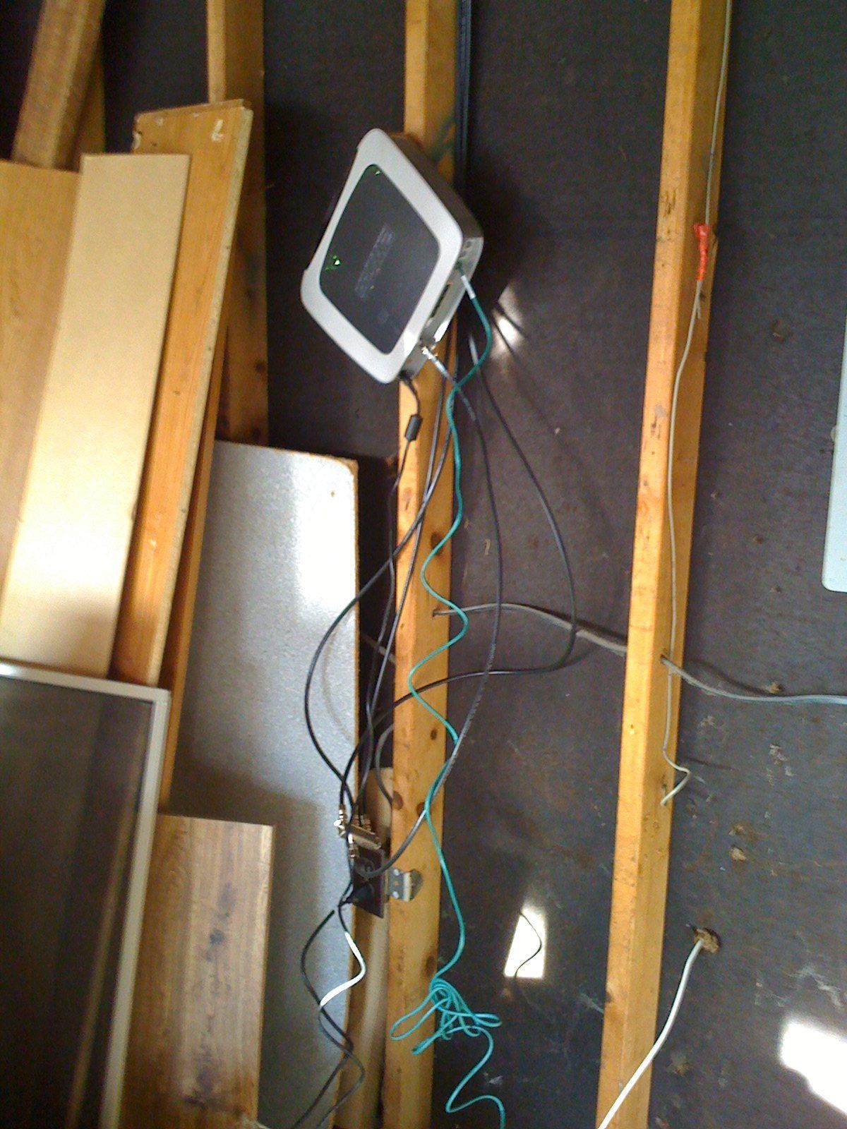

So now that were all fished and the face plates were on, they brought the wire from the crawl, and straight up in the garage like I requested, but left no service loops. Also, the tech's left the residential gateway hanging in the garage instead of mounting it to the wall. It wasn't until I requested that it be mounted properly that they did it. (it was 7pm by this time and they were trying to jet as fast as they could. So he fixed the gateway, showed me how to use the system and rolled out of there by 730. The tech said that I was one of the coolest customers that he has had and I knew my stuff. He also said the last customer that he had flipped out when something similar to the wall fish go wrong. Being an installer myself, I was kool about it as I know stuff like this is bound to happen. I just want it fixed. Im about 1200 feet from the vrad which I assume was good.

One thing I was surprsed to hear was that the techs said the cable lines do not have to be grounded, because the NID is. Is this right?
That would kind of make sense, since the NID is the point of entry from the outside.
I think the RG6 would be no different if you ran a jumper from 1 room to another room,which does not need to be grounded.
Every phone system that I've ever seen has been grounded with a pencil ground rod so I wouldn't be surprised if they were right.
I never liked flex bits for wall fishing unless I was trying to reach a tight spot and found them to be unwieldy when trying to drill. Glow rods worked really well for wall fishing and came in handy on a extra tall walls.

Quick question Goalie,
I understand there would be a reason for a drip loop out side, but your set up is inside, is there really a need for it, other than to look neat and allow extra slack for later ?
As for the ground , normal procedure is to ground to wherever the Edison is grounded, which is normally a simple ground rod.

Yes, it allows for the signal flow in the line to route better as a direct 90 degree bend could deterate the signal than a gradual bend through the wall. It also allows for some extra slack in the line if the connection ever needs to be changed.

Yea we had fake wood layed in the dining room, it made sense. In the rest of the rooms we had carpet. The kitchen, and bathroom allready has tile in it and that is staying the same. I have to go about the house and ripp all the tape off the trim so it doesnt look like we painted over the trim. (wich is what one saw in the picture above) I should be getting a call from uverse today in reguards to the damage claim. We will see how this process works.
Bob, sorry to say but the install looks like crap. I sure hope you told them they could leave things that way because you were the one that wanted to clean them up.
The install actually is much much better than that, after I told them to clean it up. I just haven't had time to take pictures.
