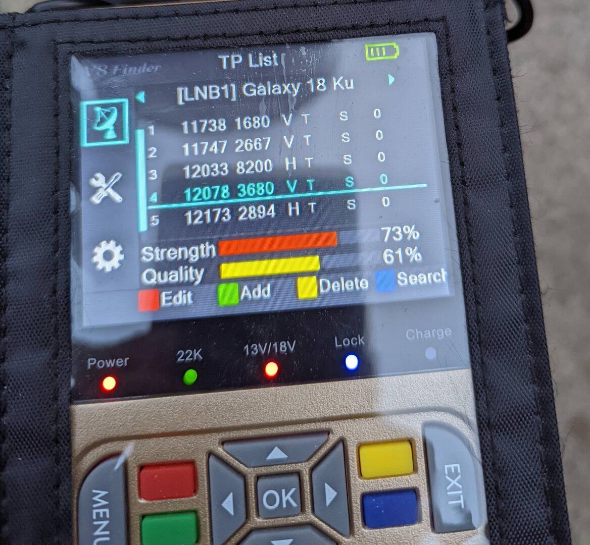

k1cza I assume you meant 12078 for PSB World. I took your advice and tuned to it as best I could. I only messed w/Elevation because I know my Azimuth is pretty close since I used EchoStar 9 and DishNetwork's TP 12016V 20000 at the very beginning.
Here are my signal levels from my GTMEDIA V8 Finder (levels are known to be low on this finder device).

It could be that the motor is off. I would check to make sure everything is completely plumb and level, then perhaps resetting your USALS settings in the receiver and start fresh with your latitude and longitude numbers.

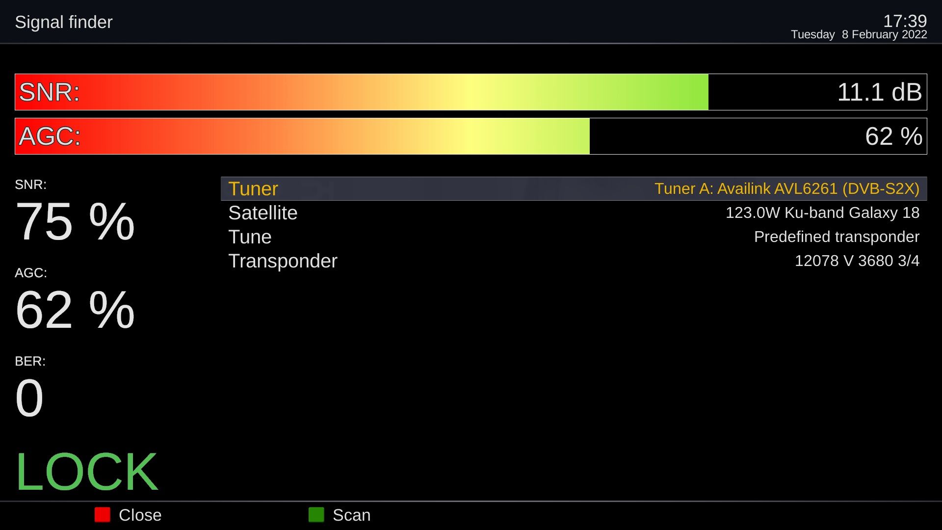

It looks like you got the transponder I suggested - it is actually Korean Broadcasting. I have attached my signal finder for the same transponder just now to help you compare, though as you have noted, your numbers may be lower.
Again I agree with comfortably_numb, it wouldn't hurt to reset your USALS/dish tracking settings, and also double-check all your installation steps. I used the STAB HH90 instructions to the letter to install my rotor, and I would do the same regardless of brand, because STAB is the reference standard for USALS rotors. Specifically, you should only ever adjust the vertical alignment using the Geosatpro's bracket, and only while pointed true south. Otherwise your alignment across the horizon will be thrown off. There is also a good thread by KE4EST on USALS install/alignment.
