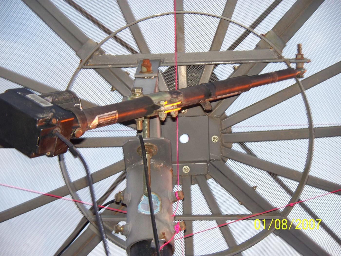

OK guys, I went out and got the dish with a little help from my big little cousin. The dish was a 7.5 Perfect10,so I'm happy with my find.I even set it up in place of my old 7.5 unimesh frankendish, I haven't even tweaked it yet and the signal quality on my pci card has improved alot (example) 95west my true south most tp are at 70quality before was maybe in the 40's, so yeah I'm happy I made the trip. The mount on this thing has the center of the dish offset.I will leave some pics for you all. And if anyone has the feed distance and the F/D info for this dish please help me out. I want to make sure I have it all set right before I play with elevation,declination and so on.

I have the 6 foot version of that dish, I like it! got it free also. Give this program a try for finding your F/D and focal point.
hXXp://mscir.tripod.com/parabola/
