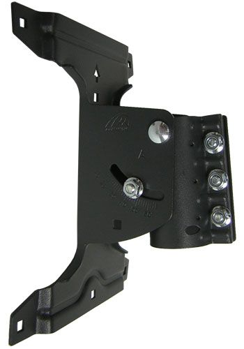

I have the Geosat Pro 36" (90 cm) Ku dish. I want to buy one of those non-penetrating roof mount deals that you put cinder blocks in. The manufacturer says the J-pole that came with the dish is 1 5/8"
Will the dish work with a 2" pole? I'm looking at purchasing this: Amazon product ASIN B003L1BCCK
No but you can get pole adapters or fashion your own.
If you get an adapter, make sure it is the kind that slides down over the 2" pole.
A 1 5/8" OD post will slip inside the 2" OD NPM mast. Secure with 3 bolts set at 90 degree angles.
I don't think that will work for this dish. See photo below. The pole that came with the dish is a J-pole, so I can't see how I would slide it into the pole that comes with the mount?
It looks like that model, the PerfectVision NPR6B, is 1 5/8" on one end of the OD and 2" on the other, so I think it might work!
Well you could cut the J off, or like Brian said go to your local favorite store and get a 1 5/8(1.66) chain link fence post. Cut to the size you want. ;)
Then save you J-Pole. :)
I designed the GSP90cm hardware. Even took the photo that you posted.... LOL! :glasses
If the NPRM has a 2" OD pole, I have inserted a 1.66" OD section of galvanized post inside and cross-bolted with 3 through-bolts on several projects. The GSP 90cm bracket clamps on to the 1.66" pole. Have also used this work-around to raise the dish to see over a roof peak.

It sounds like one side of the NPR6B pole is 1 5/8" so I should be good with that model as-is, right?
