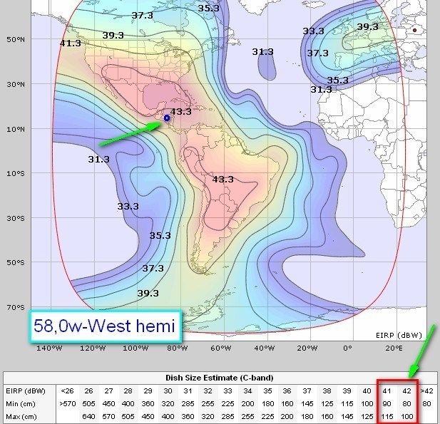

The satellite name has changed to Intelsat 21 and the footprint for the CTNi signal can be viewed here:
http://www.intelsat.com/flash/cover...at=IS-21%20at%20302%BA%20E&display=map&spot=0
Broadcasters usually will recommend a dish size that provides a margin of signal gain that will provide minimal interruption during adverse weather conditions. Looking at the estimated signal strength for your area, a 2.4m dish will likely provide reliable reception in all but the most extreme weather. A larger dish would minimize signal loss during these weather events.
Proximity of your downlink to the equator has no relationship to satellite signal strength. Satellites have directional antennas that often direct the signal to specific regions and may have no signal available in your region.
Intelsat 21 - 58.0°W
We have been told that we need a 4 meter dish by CTNI, but local cable operators and others say a 2.4 meter dish will work great. I always thought that closer to the ecuator that you are the smaller dish that you could use,
You wish to throw on money - $. Dish it is necessary less size. Look a companion card.

BTW, I just moved my 6 foot Dish over to 58w, and am now watching the broadcast on 4122/H/2222 coming in right now with a 90% level and a 54% quality, still very watchable, and I don't yet have this dish tweaked out. Based on the Chart posted here by Borisov, I am in about the same signal strength, here in North Central Florida, as you would be.
