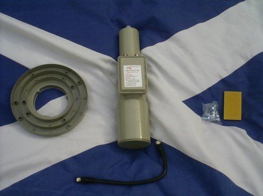

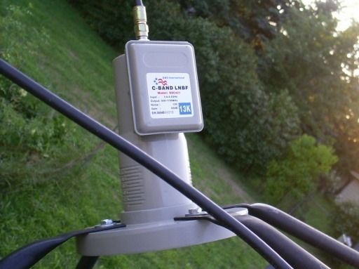

I use the Voltage controlled BSC-421 C-Band LNBF, its all controlled by the receiver just like a Ku LNBF. It will also work for Circular C-Band signals by inserting the Dielectric plate that comes with the LNBF. (As does a scalar ring)
I got it from DMSi one of their dealers may ship to the good old UK.
http://www.dmsiusa.com/links_page.htm
http://www.dmsiusa.com/images/bsc421a.jpg
http://www.dmsiusa.com/bsc621-2.htm

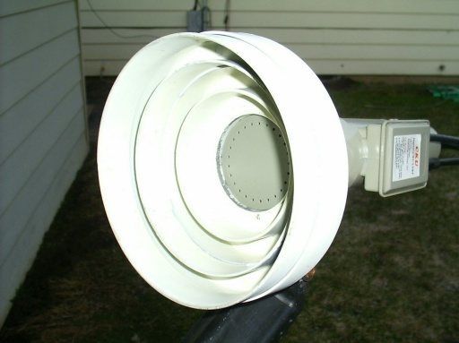

There is also a C/Ku band available from the same company, see below pictures....

Hi again that c-band lnb-f would not work on my 1.2m offset andrew dish as they are for prime focus only i need to use the feedhorns in the link below
http://www.andrew.com/search/BN_PA-100530-EN.aspx
Also this is the dish i have
http://www.andrew.com/search/BN_PA-100547-EN.aspx
could i use a andrews c-band linear feedhorn and put a Dielectric plate in to get circular
Is it possable to get to get voltage switching c120 flange c-band lnb's

The above LNBF's have been used with off-set dish with success, but you are right they do perform better with a matched conical scalar ring. I use the below when using the above LNBF's on my off-set dish.
Just bolts right on both of the above LNB's

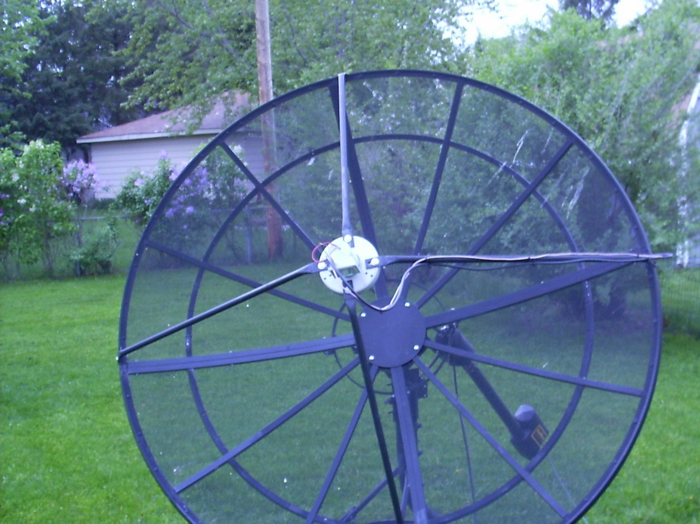

Also what do you think about this 1.8m fortecstar dish i can get one for £99.00 gbp thats about $180
http://www.maplin.co.uk/Module.aspx?TabID=1&ModuleNo=47165&doy=7m9
PSB said:
The Fortec Star 1.8m is a good dish! fellow Mod. Iceberg has one and really likes it! You should have MUCH better results in the UK!

as PSB noted, I have the 1.8m dish and love it. Its not motorized (I ghetto move it to the satellites) and really don't have any issues. With the 2 degree spacing we use here in the US, some signals are tough to get but all and all I'm happy with my results :)
Most of my satellites that I can see are about the same elevation so I just turn the dish :)
