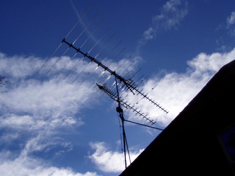

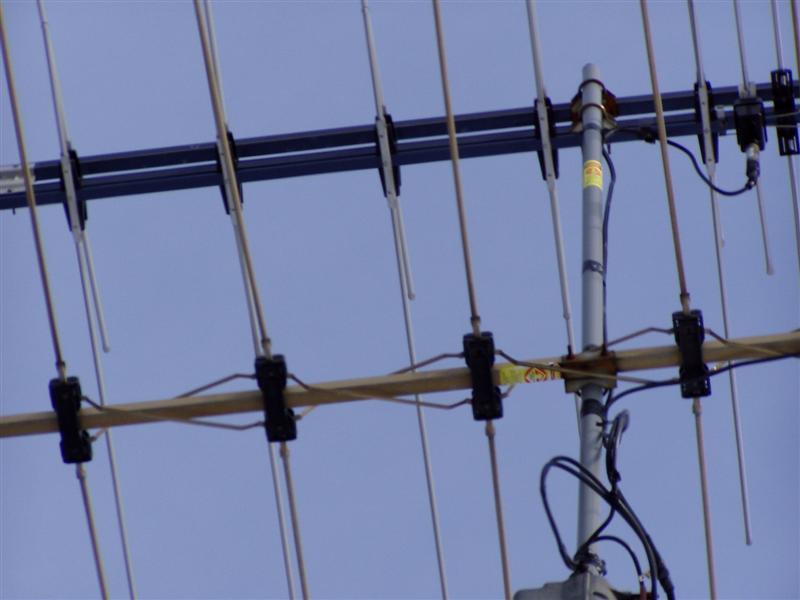

I am 12-19 miles from the local towers and use an hd8200p for vhf and a 91xg for uhf with an hdp 269 preamp and I split the signal about a dozen times. overkill in antenna size recomendations is bullcrap and so is advising against a preamp. You just need to pick the correct amp for the application.
