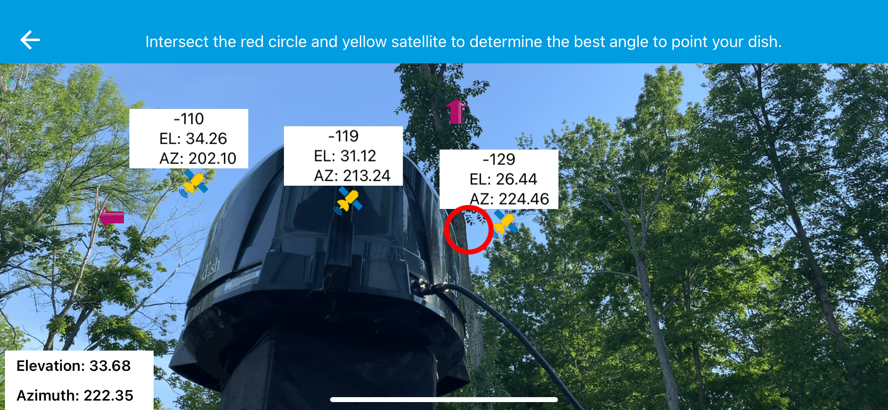

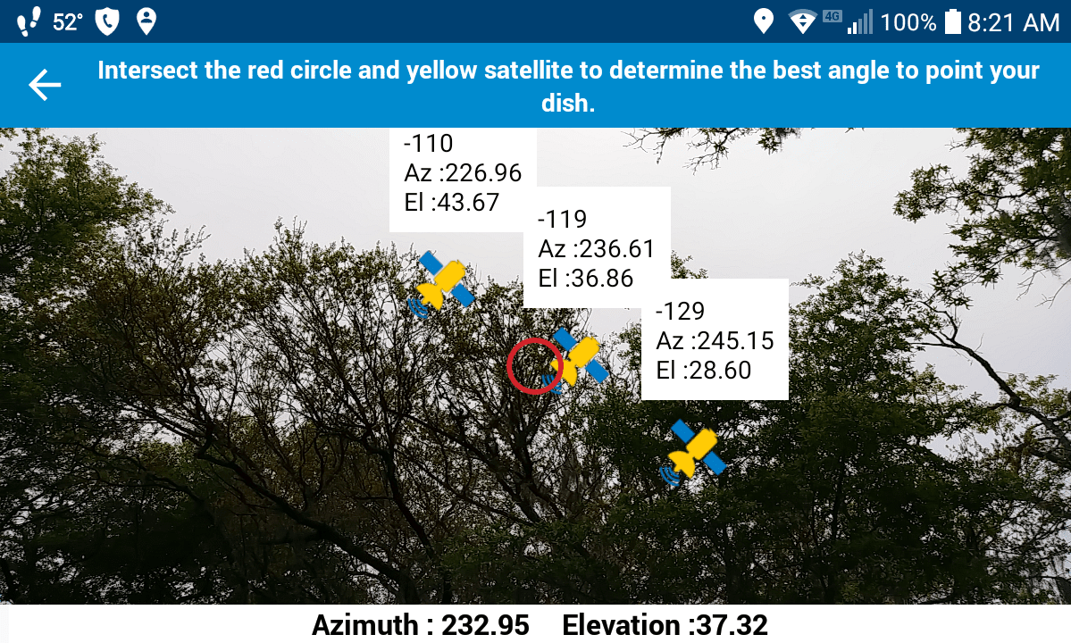

Get the Winegard TV Signal Finder app and it will identify the sats in the AR view by location. The screen shot below obviously shows a location that was not suited to western arc reception from that spot. ;)
(scroll down)
Winegard - TV Signal Finder App
Thanks again. Exactly what I needed. Found another app that had AR which is how I found I needed to move to the front of the camper. But neither app I downloaded had E5/G27
