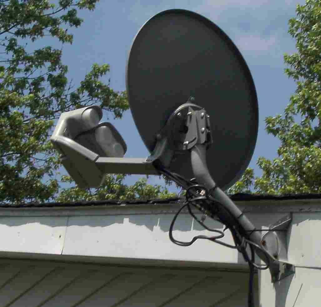

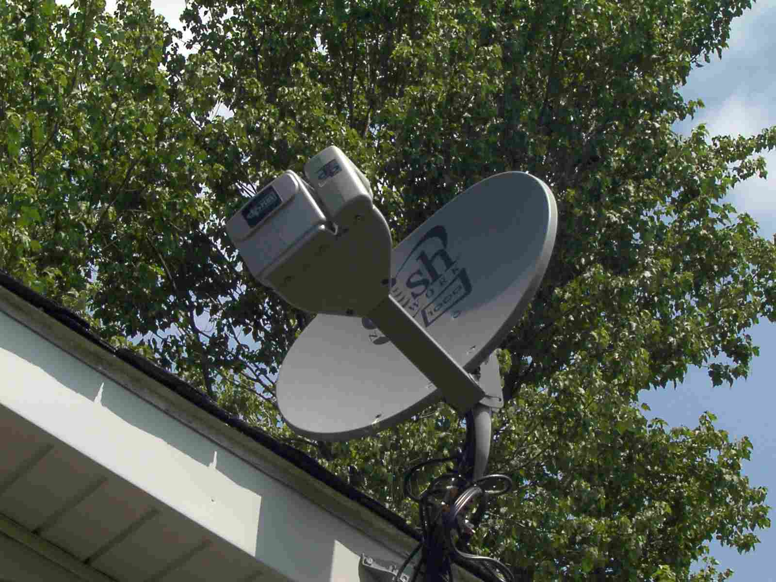

I can post a picture if it would help
I have been reading about the possibility of using the 300 that I have if I just add a sw21. I think I could pick one of those up pretty easily. Would that be a difficult setup if I could do ti?
here is the outside setup
you lost me for a minute there....are you saying I have all the pieces that I need already?
If I remove the single one from the 1000 and use it on the 300? that makes sense. The 1000 won't have an lnbf where the single was at (or I could use the old 300 one as a dummy)?
