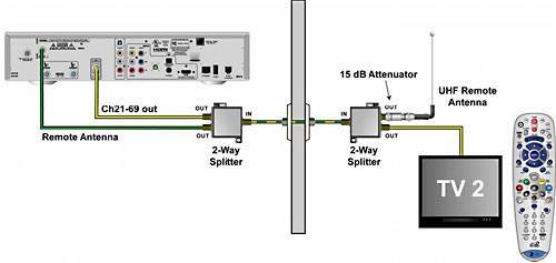

It should make some difference, but if not you'll probably have to do this
Thanks I'll give the back feed a try. Is there 15 db Attenuator required to make this work?
