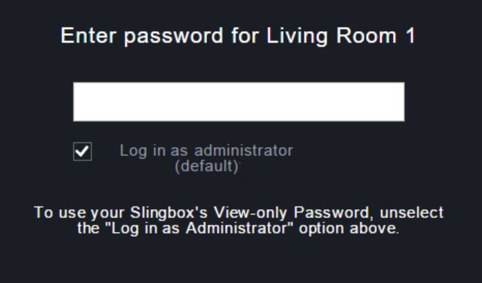

I have a Windows 10 2-in-1 (detachable tablet) with the SlingPlayer app installed, and I also downloaded and installed the SlingPlayer Desktop application, and entered my account information into each. When I start the app, it prompts me to "Choose your Slingbox", but offers no choices in the list. When I start the Desktop application, it seems to recognize my Hopper 3 named "Living Room 1", but asks for a password, and I have no idea what that might be.

In the SlingPlayer Desktop application for Windows, here is the screen that I'm stuck at, after logging in:
That app and application is for a real external Slingbox attached to your DVR, not the Hopper built in Slingbox.
OK, this is progress, But as I asked before, after logging in and choosing the DishAnywhereTM at the very top of the page, then what?
