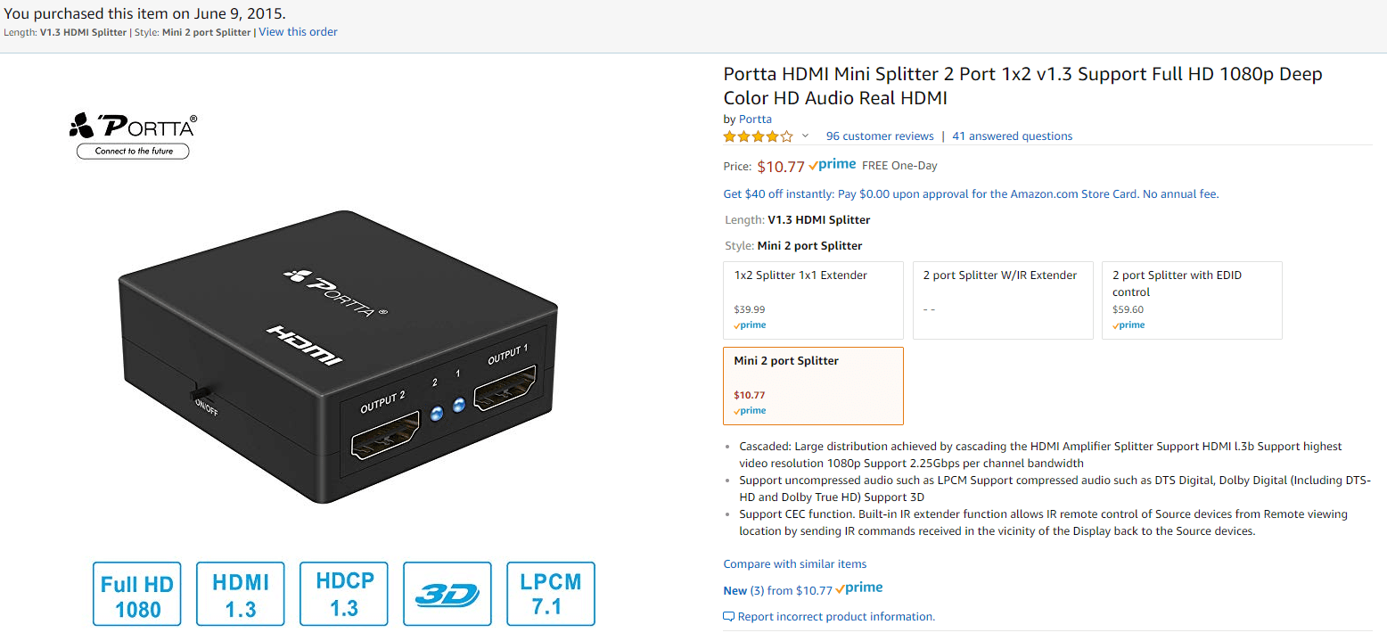

I bought this one 4 years ago and have been using it with my 722 since. No issues. Link doesn't seem to be working so here's a screenshot.
Amazon product ASIN B007K1KWTQ

Great!! Thank You! The link worked great. I have two that are like that one, which are the ones that work for a couple of days and stop. BUT you are using a 722. I have read posts that people with 722's most any splitter will work. WHILE with or when they switch to a Hopper3 they don't. That's my problem. I'd like to use the HDMI cable I have run and get the "best" picture, but I just may end up running a Component cable.

I'm seeing that they are all mostly the same, even a whole series has the same graphics on the Splitters, but different boxes. This unit is an HDMI 1.3. Probably too low for an H3. Thanks though.
