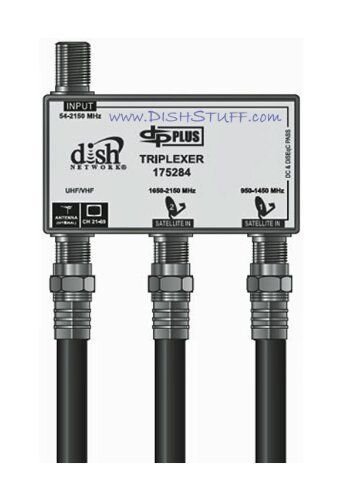

This is the triplexer. The connector on the left is for an antenna. Don't know if it matters, but I don't have the dvr, just the 722k receiver.

The 722K is a DVR.
If the OTA and satellite signals are each coming in on different cables you do NOT need to connect them to the triplexer. the OTA should connect to the OTA module and you then connect each satellite tuner to the satellite. That connection would normally take place using a separater not a triplexer.
