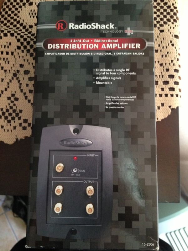

Yesterday it was raining badly in my area and I started to see some pixelation on channel 2(the weakest one so far) so I did two things, I raised the antenna by replacing the 4.5ft pole I had with a 6 footer. Then I went to radioshack and bought a 1-4 distribution amplifier(great reviews and got it for $25 on sale here). And now my picture is perfect on both TVs.

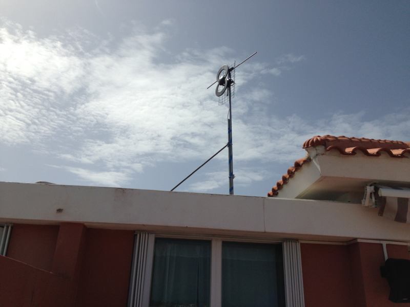

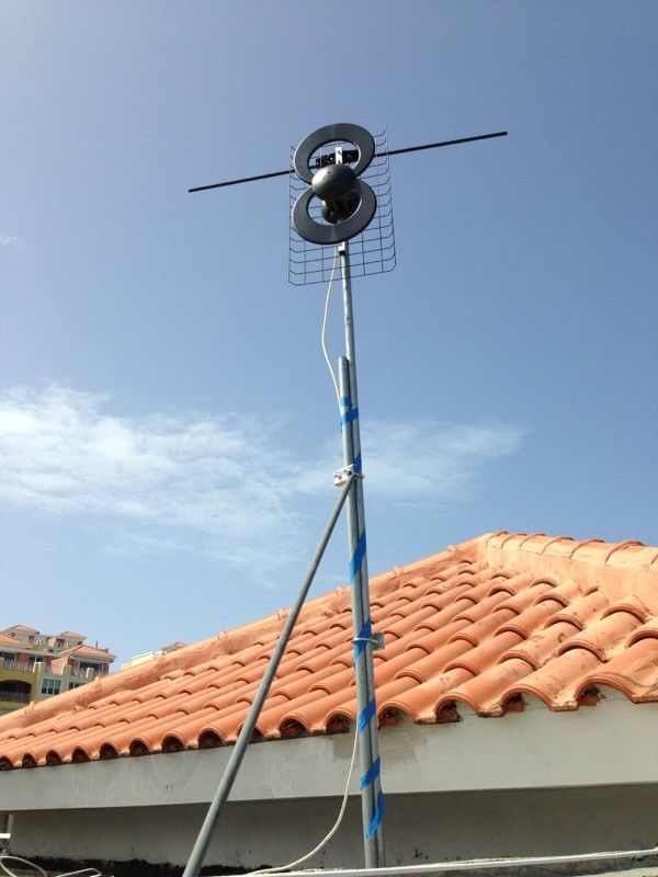

Here are some pictures of the finished product. Made with 3/4" pipes attached to the original mount's base and a leg from a giant old dish that I had so it doesn't shake with the wind. Its amazingly sturdy. (Ignore the blue tape, had it there to hold the pipe so I could test the signal before drilling the holes for it.)
That antenna has little gain on the VHF band, it your want ch 11 look at a Y10-7-13 type antenna either from Antennas Direct or Winegard.
Another possibility would be to build your own channel 11 yagi out of pvc and brass rods from plans and directions on internet sites.

I also moved the antenna since I found another hidden yet nice spot to put it on the roof, its late now but I'll snap a picture of it tomorrow. Signal is the same as the pole.
