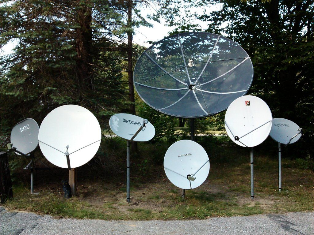

RT-Cat is that an alien painted on your Direcway dish?
Yes. When I can't get a signal, I call him up and he comes from space and makes everything work purrrrrfectly. WOW! I never saw that in the picture taken last year. I just went out in the light rain to check. Some of it is dirt and some is just the surface material coming off. Looking at it just now, you can not see what shows up in that picture.
Maybe I caught one of the spies from another planet that is/was checking up on us to see if they want to visit. I hope they are smart enough to stay away.....
