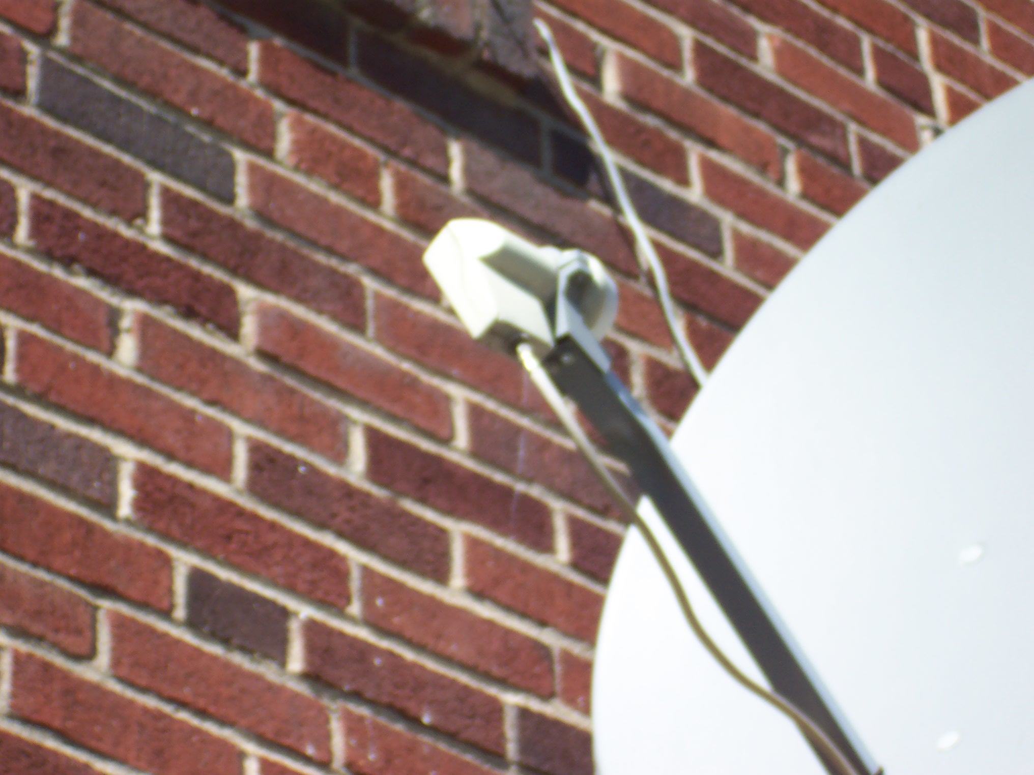

If you'd show us a picture of your existing LNB on your dish, we might offer better advice.
But choosing a Standard LNB versus a Universal LNB (as you have), is probably the best way to go.
What size is your dish, and which satellite are you watching?
Hello. The satellite we watch is IntelliAmerica5k. I will try to take a picture of the satellite dish soon.
Hello. Here are two pictures of the LNB from different angles.

The article from amazon it's a dual circular Ku, you need a dual output linear ku or universal ku (it's also linear but with extended freq.), you need something like this:
