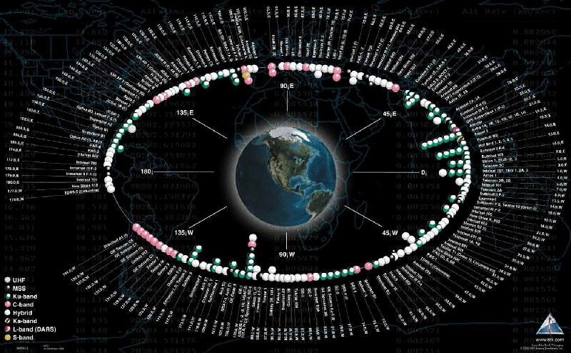

Some things to note when finding sats. One getting a signal meter helps. The are cheap and the sponsers sell them. Two when looking at the sky the sats are NOT in a straight line. If you face south the sats to the left are higher then the ones to the right. So if you are on 119 the dish elv is higher, points up more, for 97W since it is to the left. Also note you need to the dish 22 degrees to the left. To make this even more fun some dish elv markings are off a bit. If you note the elv you are at now you can figure if the dish you have is off and by how much. I wish I could find a pic to show this. I did find one showing some in the clark belt around the world.
Ken,
Where did you find this image of the Clarke belt? It's the best that I've ever seen. I did a google image search, but didn't find this one.
Thanks,
Tim
PSB said:
If you like that one check this one!!!!!!!!!!!!!!!!!!!!!!!
Pete - Thanks! I agree with Jeff. THIS is the best one that I've ever seen. I've been looking for about a month and never came across anything nearly as good. Thank you.
Aldnes- I hope that I didn't hijack your post. Good luck with your setup :)
Makes a GREAT color poster, it can be blown WAY up in size then printed out :)
Google image search. "Clarke belt satellite"
Thanks for the pdf PBS
