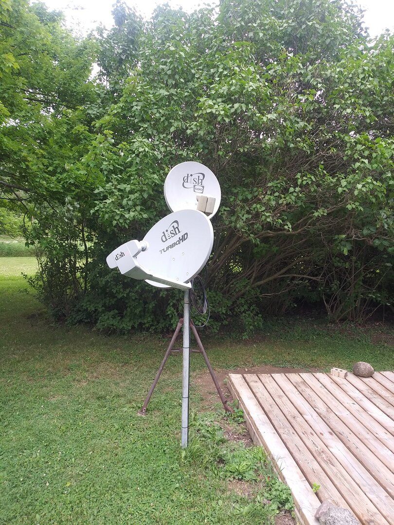

You mean like this.. LoL.. I got tired of switching lnb's...not perfect but works for me

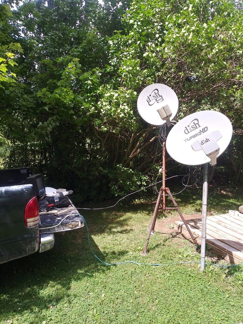

Sorry been busy. My west feed dish hasn't had anything done to it in 4-5 years so think I will try to see if any tweaks can be done to improve signal before swapping to the east arc. I plan on taking a small TV and receiver out to the dish setup so I can monitor. Instead of hauling my VIP-211K out there can I use my older 301? I know it doesn't do MPEG-4 but aren't there still some MPEG-2 channels and transponders on 110 and 119 I can lock onto? If so what transponders would I look at? Thanks.... We have been watching HD channels from 129 off and on so maybe a tweak will help.
No, the 301 will not work. There is still MPEG-2 on Western Arc, but it is all 8PSK now. The 301 will only handle QPSK, which is no longer used. You would need at least a 311 or newer, so your ViP211k would be your best bet. There may still be some QPSK at 118. However, that satellite requires a special LNB, and a dish with a larger reflector. Simply upgrading to a larger dish may help with your signal issues. However, if something is actually blocking part of the signal from getting to your dish, then a re-point to Eastern Arc is still the best bet for a long-term fix.

I just received my 2nd VIP-211K to use for aiming purposes. So when it quits raining, which may be a few days, I am going out. I did find when I looked at my present west arc setup my skew was off, supposed to be 122 and it was 118 so I did set that and having fewer problems with signal. I will check the azimuth and elevation when I can see how it affects signal strength. Also I do have the Dish 500+ antenna which is larger than my 1000.2 but need to buy the LNB setup for that. Shall see what happens when I can tweak, so it's possible I may not need to re-aim for the east arc. I will post here the results when I can get out there, thanks for all the help....
Well I got out today, rain ended for awhile to do some testing. I mounted a Dish 500 on an old antenna tripod I had sitting around and leveled it next to my present setup, see pic. I got signal on the temp dish and tweaked for best reading. I thought I would compare readings from the Dish 500 to my current setup. I tested 6 transponders, 16-21, on 110 and 119. They both ended up very similar so guess it's what I have. I didn't check 129 but know it's a weaker signal.
110 signal from 54-73
119 signal from 53-68
I then moved the Dish 500 to pick up the 2 east sats to see what I can pick up there. I may not have zero'd in on the signal, I did check 61.5 then had to swing the dish a little to pick up 72 as it's more than 9 degrees apart. Here's what I got there, I checked transponders 1-8.
61.5 from 55-65
72 from 38-47

Dish 500 .
61.5 from 55-65
72 from 38-47
Those numbers are pretty much spot on what I get when I use a D500 for EA. As long as you're experimenting, spin the 1000.2 Eastward and use the WA LNB to pick up 61.5 and 72. The third eye will come up empty, but IIRC you 'should' get a little better reading on 72.
