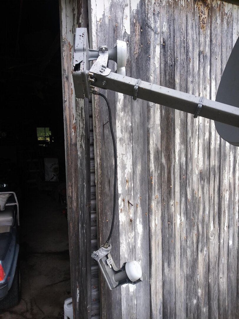

Well sucks to be me, got my LNB and had it setup on my antenna stand ready to do some checking. Then last night had a serious storm pass thru with alot of wind and this is what I now have. Ordered another this morning, crap....
