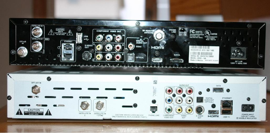

BTW, the HR20 only has one ethernet jack.
BTW, the HR21 and HR22 has 2 ethernet jacks.
I think I remember reading the top one is the ethernet input jack and the bottom one is an ethernet passthru so you could plug your videogame or some other device ethernet connection into it.
Nope. It has two. I have an HR20-100 and there are two Ethernet jacks in the back
attachment.php
Courtesy of DBSTalk
HR20-100 on top with two Ethernet Ports
HR20-700 on the bottom with one Ethernet Port
