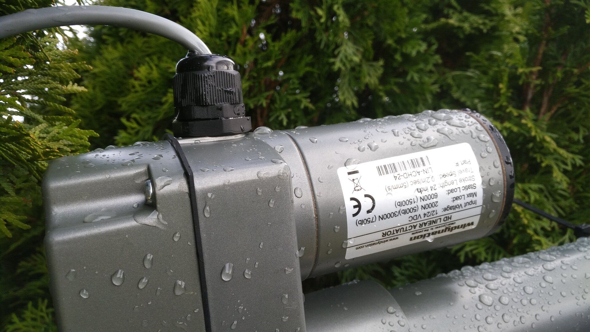

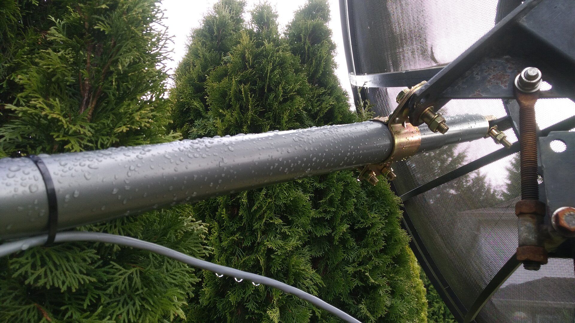

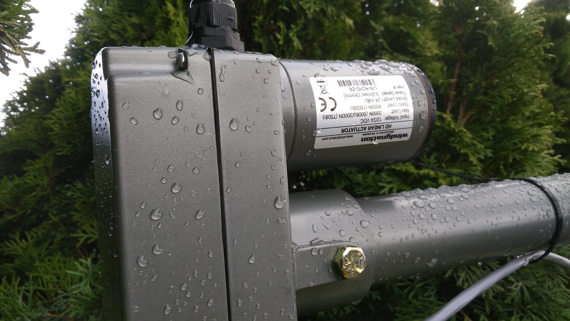

So far so good. It's been super windy and gusty since I put it up 3 days ago and is doing its windynation duties, I guess. I think it is faster than my old one, too.
If it's one of those 24V models then it will run faster with 36 V hitting it.
Here are some pictures of it.

I have two solar arrays of six panels each using the LIN-ACHD-24 on each array and controlled with a solar tracker. These are supposed to be water tight but some how water gets in and shorts out the board. I am in the high desert of Northern Nevada where we get very little rain but quite a bit of snow. Another issue that has come up several times is the rubber gasket between the circuit board plate and the gears. Over time it gets loose or soft and the gears get clogged with the rubber jamming the gears and burning out the armature and or brushes. It is basically a strong solid actuator but it does have some design flaws. Another problem is that the company has not been helpful in getting parts so I had to buy another actuator. When it failed I used parts from the old one.
