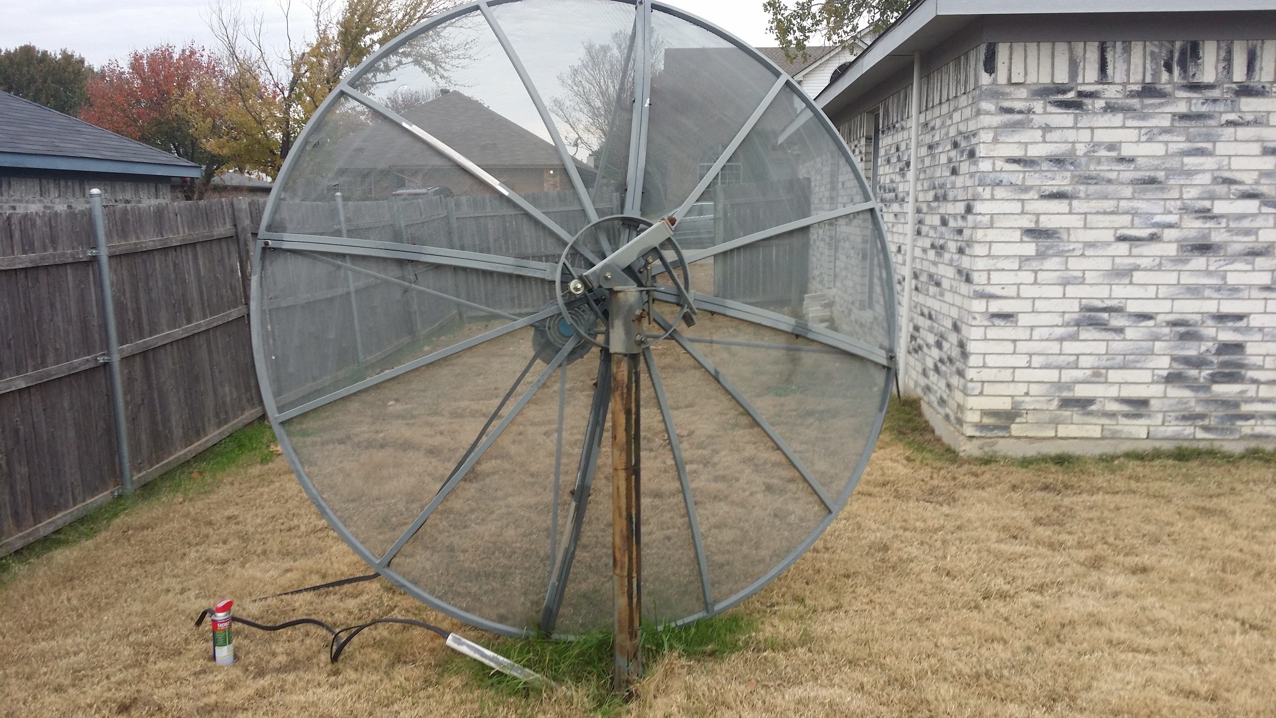

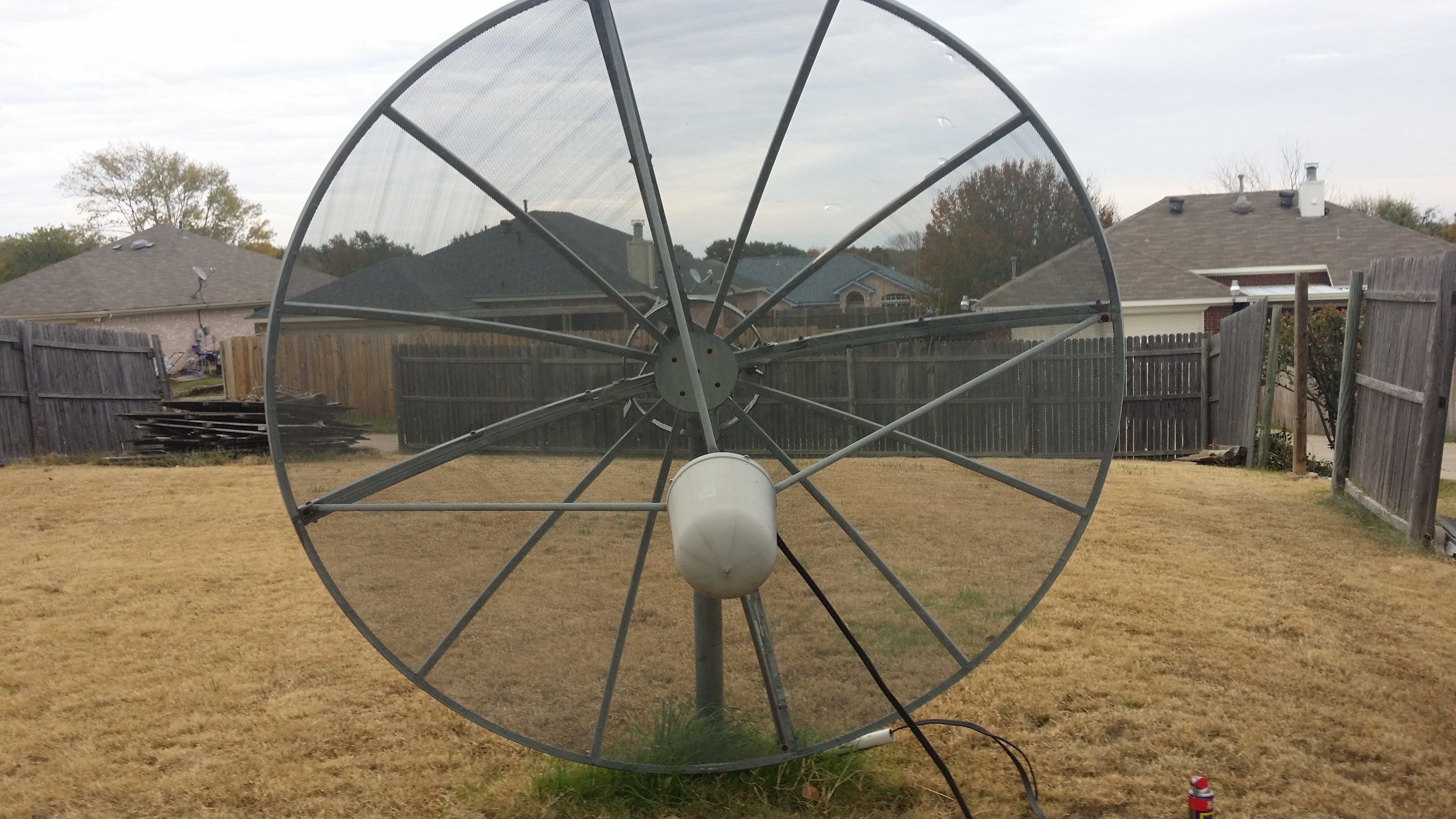

Here is my new to me free 7.5ft bud where can I find out information about the laser brand or can someone tell me if it is a different bud

I didn't know you lived in Australia! LOL
You find info like everybody else. You search Google for it, and hope for posts from this or other forums. Laser is just a generic brand like many others. It's as good as you want it to be and your skills of restoration, and if setup properly should do ok. It would be better as a 10 footer, but this will give you a good taste.
I would suggest trying to remove the dish whole, and getting it to your place. Then, I'd "string" it and see if you need to deal with any issues there. If it's been like that for a couple years without the actuator, and flopped down, it may have distorted it. Any dents can be dealt with using a body hammer and block. Rips can be sewn up with picture hanging wire. Lot's of oil used on bearing points, and then work them for a bit.

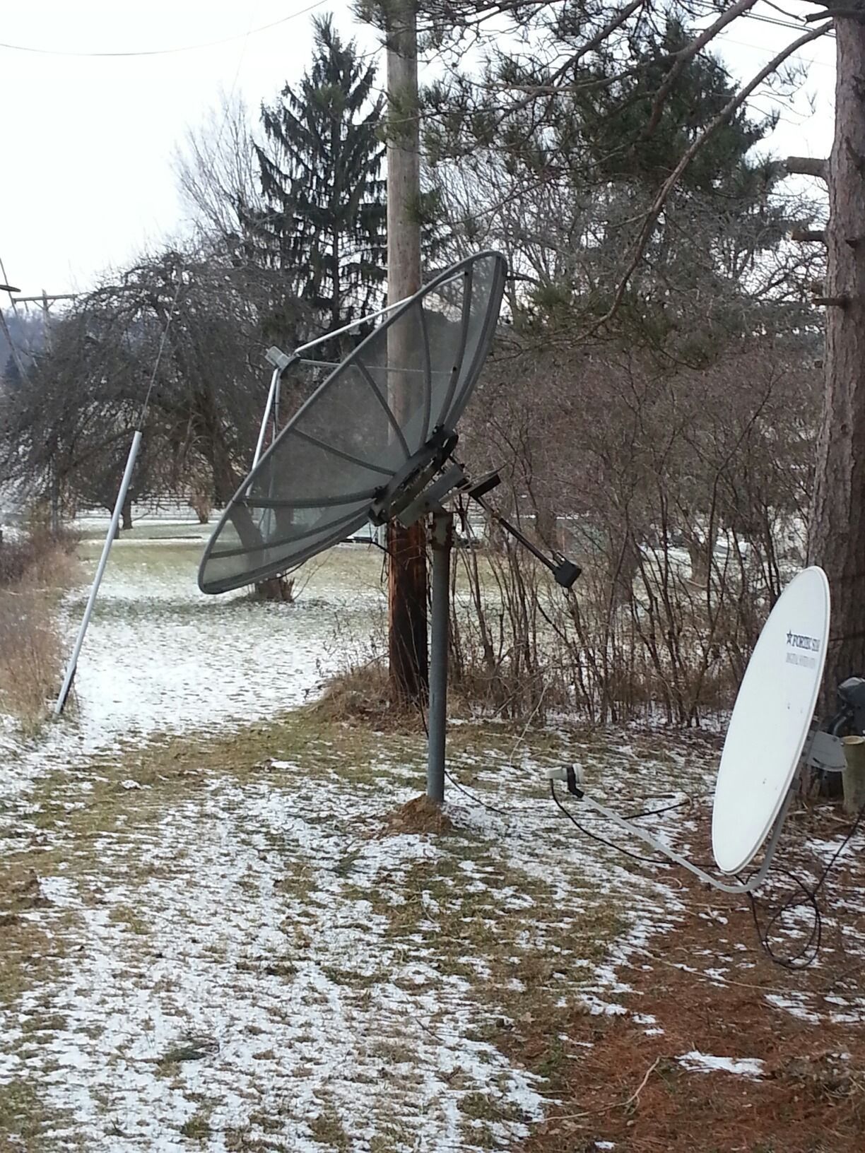

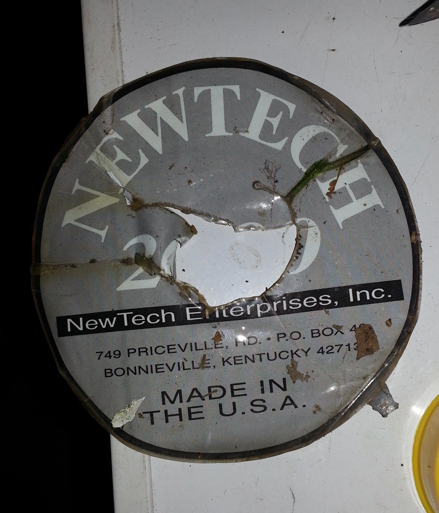

newtech.jpgdish.jpegI cant say 100% but it looks similar to mine and every (EVERY!!!) bolt broke off when i took it apart. Obviously Newtech didn't use stainless bolts.

View attachment 93860View attachment 93861I cant say 100% but it looks similar to mine and every (EVERY!!!) bolt broke off when i took it apart. Obviously Newtech didn't use stainless bolts.
