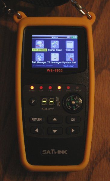

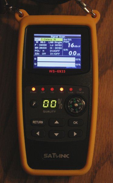

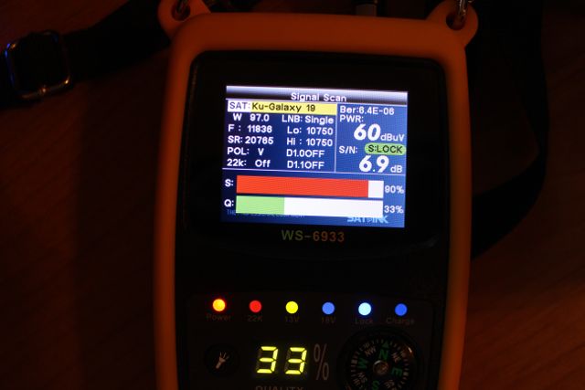

I've been using a Satlink WS-6933. Inexpensive but gets the job done. It has a built in flashlight for adjusting at night. Also has a compass but I don't trust mine. ;)
USA SHIP Satlink WS-6933 DVB-S2 FTA C&KU Band Digital Satellite Finder Meter US | eBay
Here are a couple pics of the menu and signal screens (thumbnailed - click to enlarge). :)

Hmm... looks fairly tempting. Is it fairly easy to update TP info via USB?
As for the compass, the version on Amazon doesn't even have one.
Satellite info can be changed 'on the fly' in the menus so no need to connect to a computer. :)

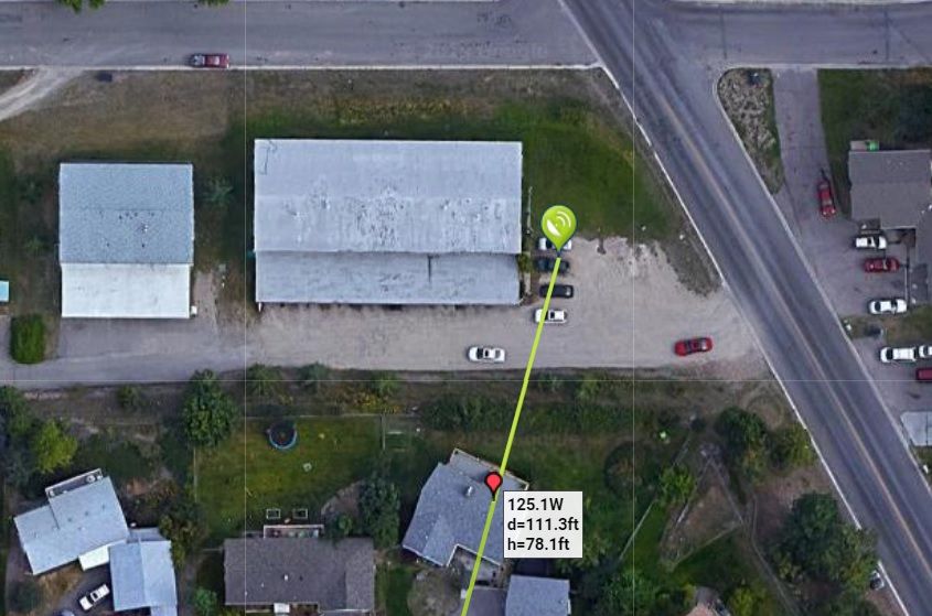

She said it could go on the east side of the building, which was my plan anyway. It's a fairly tall dish stand (came from a guy who used Dish Network in his RV), so I might be able to put it right behind the curb of our freshly paved parking lot without having to worry about cars/trucks blocking it.
Welp... nothing yet. Apparently there are some big maintenance issues at the landlord's other property, so the maintenance guy should be running the cable some time this week.
Wife is impatiently waiting for 125W. The antenna gives us the occasional blip on KSPS, and our building plus a hill block Montana PBS. I'm looking forward to the picture quality of Nature & Nova on the national feeds, and tying the 125W Montana PBS signal to the OTA EPG will be a nice bonus.
