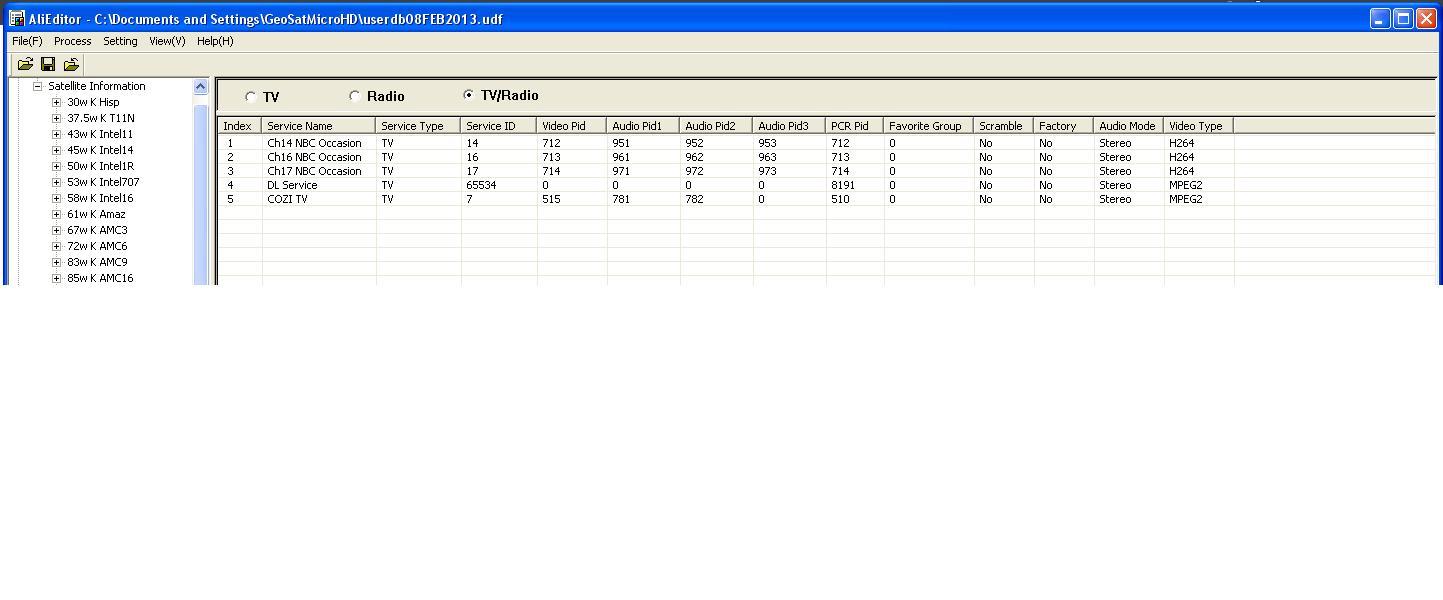

Please try using the attached udf channel list as I have been unable to get either editor to edit the file properly. Media Box Editor appears to change the encoding while exporting. I import my channel list in GSP microHD mode, copy my channel (and change the SID) and export The channel list in GSP microHD mode plays on the TV with black video. (i.e. black screen with audio) When this file is loaded back in again, MPG is changed to MP4.
Adding a new channel with ALiEditor corrupts the channel list and causes the box to keep re-booting. I did change the box type in the ini to M3601s as well as the path to the ini file.
With both programs, I am loading the file via a USB stick. The channel I am trying to duplicate is COZI TV on 103w

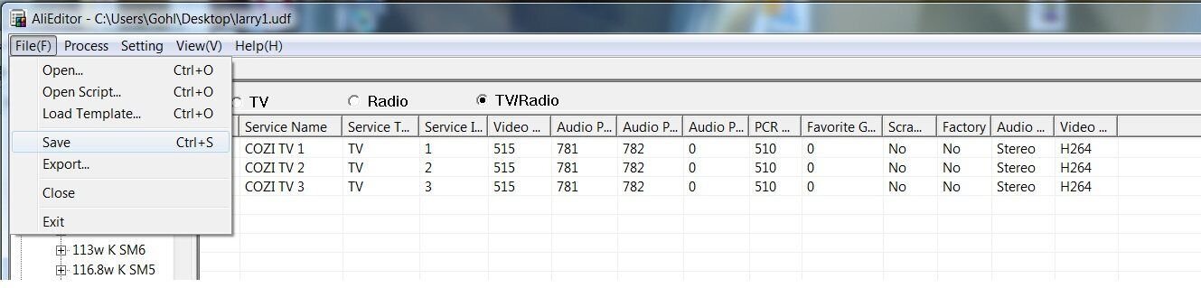

I downloaded your .udf, and opened with the ALI Editor.
Deleted all channels but COZI TV, Added COZI twice and saved with no corruption. Loads to the microHD without issue and displays the 3 Cozi Channels SID1, SID2, SID3.
Isn't Cozi h264? Don't have 103w KU at home so cannot test. Try attached .udf file.
How do you save the ALI Editor .uhf file? You should be simply pulling down File and clicking "Save". See photo.

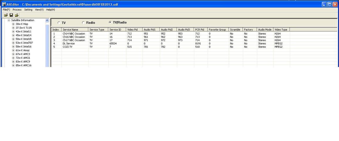

When I look at the original file that works (as posted previously) it lists the video as MPEG2. (see pic)
That was why I was trying to set the video to MPEG2. When I edit either file (the new file from you or my original file) to set the video to MPEG2, the box goes into the rebooting cycle. Yes pulling down File and clicking "Save".

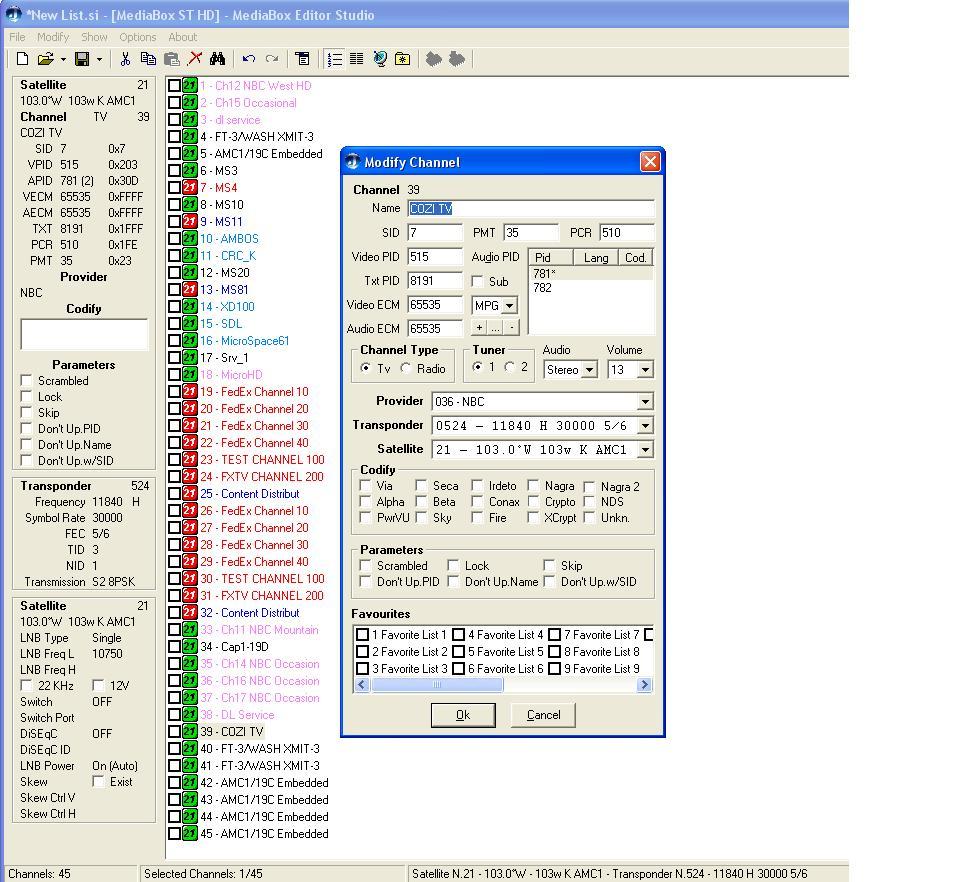

When the original file is loaded into MediaBoxEditor, it also lists the video as MPG. (see pic)
But if the channel is copied with MBE, it changes this setting when the data is exported to GSP microHD udf file.
