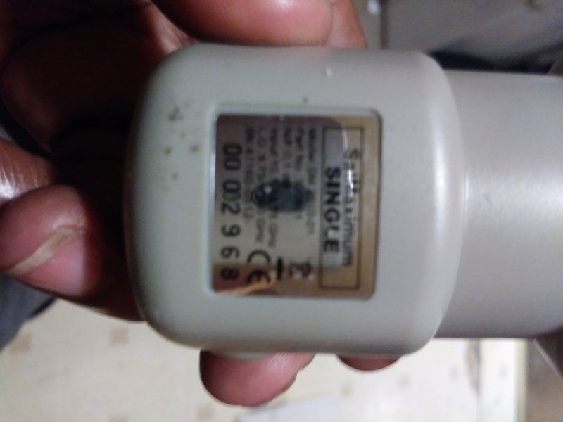

Well I have a 0.1 dB SatMaximum Single lnb. I also purchased a 0.1 dB Universal Single KU LNBF MX-11. Well I've looked online and here Galaxy is a good sat but I'm trying to pick up any Sat at this point like I said I'm new to FTA so I'm trying to get a signal

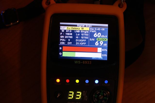

Your a great help I can get the DB up to 76 but have no signal quality what tweaking do I have to do
Are you trying for 97w? At my location using the WS6933 I have 11836 V 20765 on 97w locked on an 80cm dish (about 31") with the following readings:
I haven't touched the dish since last fall so I might be able to get better but I do have a lock. If you are aimed properly at the sat and on a known good transponder the green S:LOCK will show on the display along with a Q reading and the lock LED will illuminate. Your readings will likely differ from mine based on which transponder you are aiming with but this is what you are looking for in general. Have you verified that you are using the correct azimuth, dish elevation and skew (verify with dishpointer)? What tools are you using to aim the dish (compass, phone app, etc)?
Make sure your lnb settings are correct in both your meter and your receiver. Verify that your lnb is skewed the proper amount and in the correct direction. When aiming the dish, loosen the mount just enough to be able to rotate the dish on the pole (azimuth). Rotate left, then right very slowly until you get a lock. If you get a lock do a blind scan and compare the channels with www.lyngsat.com, www.sathint.com or www.tvrosat.com to see what sat you are on. If you get no lock raise or lower the dish elevation a little bit and repeat the above. Movements must be very small because a fraction of an inch means the difference between a strong signal and nothing at all. Be patient and you will get it.

Ok I'm using a phone app compass and dish pointer I'm also using the sat finder app. Ok now is the azimuth the compass direction and am I supposed to adjust the Voltage on the sat link am I supposed to adjust the lnb
Someone else will have to comment on the accuracy of a phone app compass as I use a real one ;). Yes, the azimuth is the compass direction in degrees. When you select a vertical or horizontal transponder the meter will set the proper voltage - 13v for vertical, 18v for horizontal.
