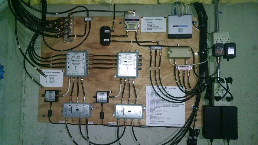

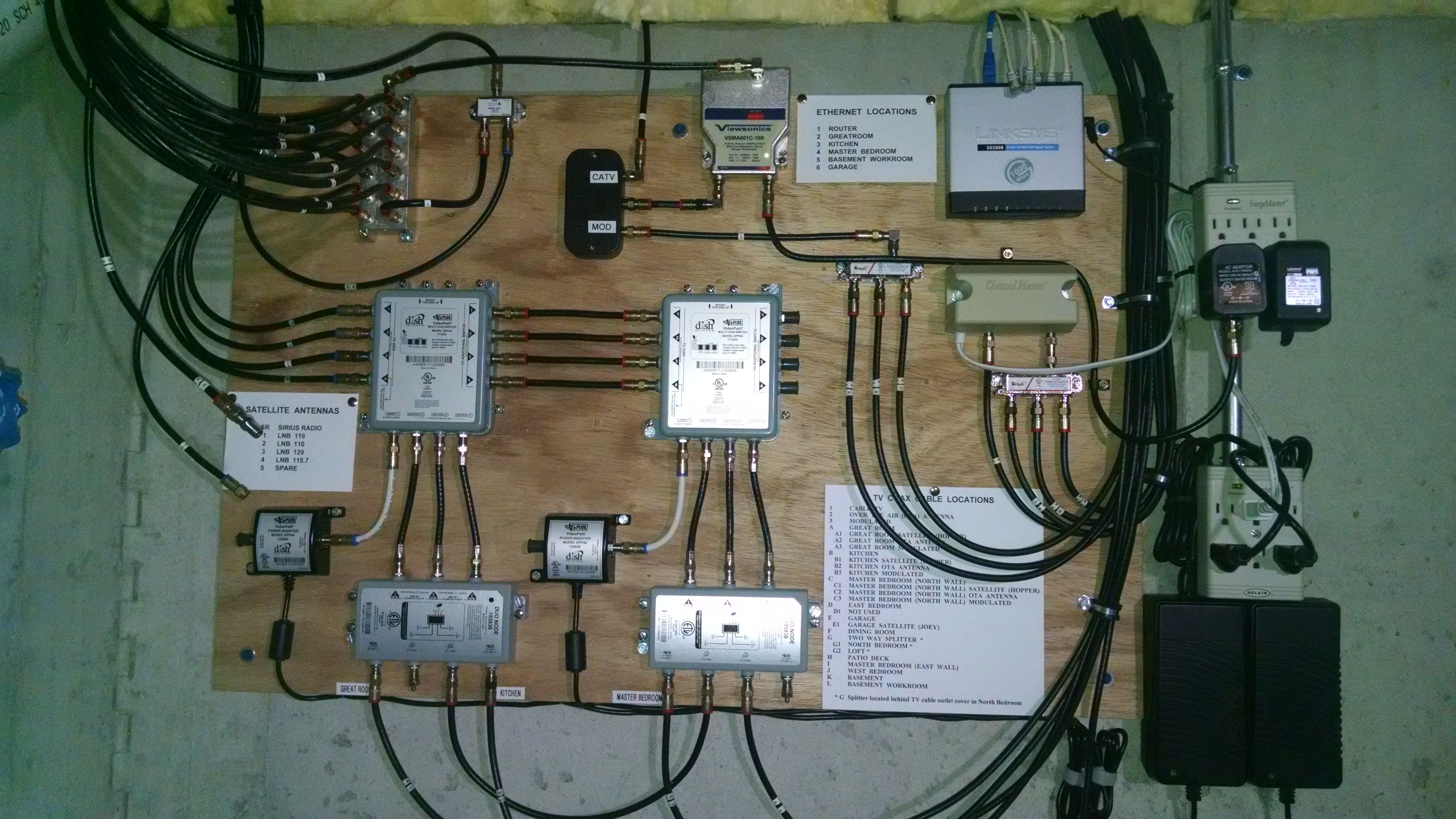

I actually have a central area as you describe. I have 11 coaxes from outside going into my basement.
Yes 11
6 of them are cable 5 of them are for Satellite.
Obviously it's all enclosed pipe.
But yes I have a duo node in the basement, with a DPP44.
Cable just has a grounding Block
I tried to get the cable company to just put the single RG11 right into the basement, But they insisted they split it outside in their lock box.
Even though I pay for all 6 outlets anyway.

Here is my red neck central area. When I upgrade to the Hopper 3, my board will look empty. LOL
