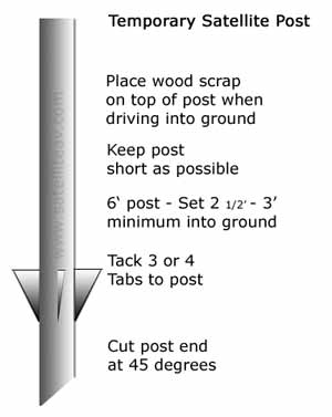

If you can't set a post in cement like suggested previously, try this design for a very stable temporary post. Place a post level on the pole while driving and you should have good success.
