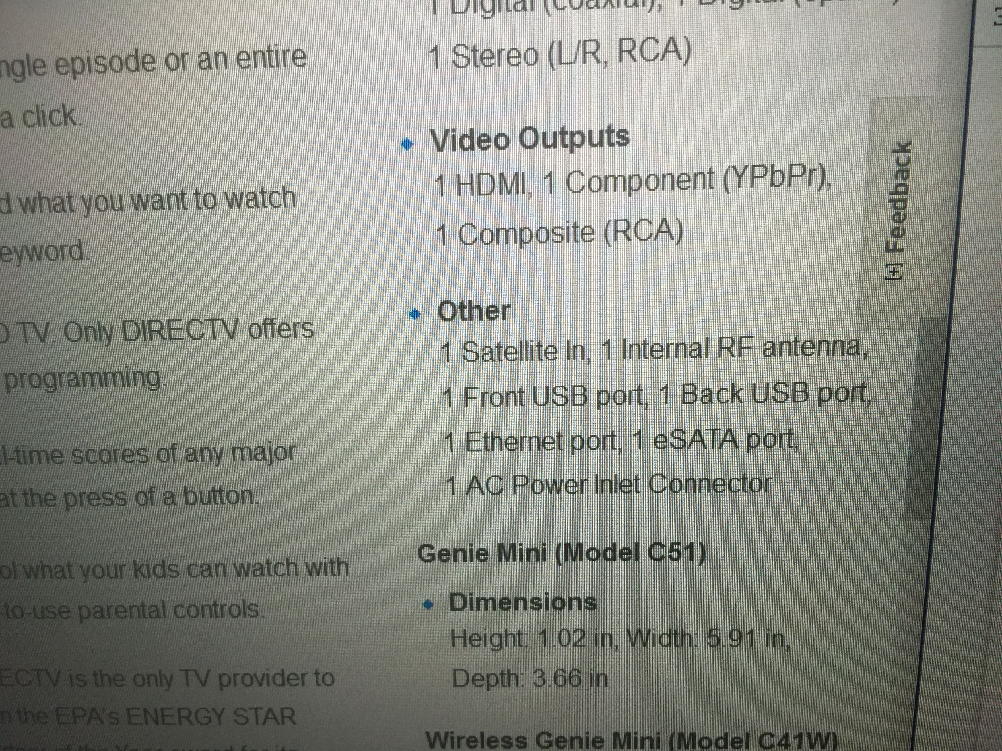

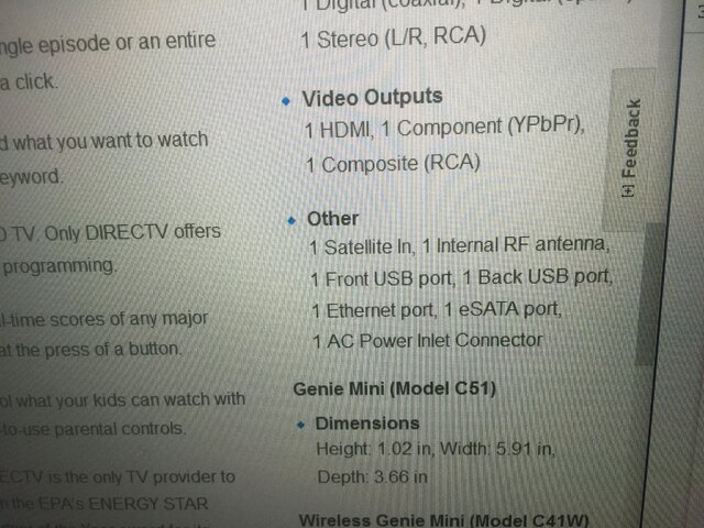

It looks like based on taking to direct tv tech Sopport the he-54 has an included over the attena is that true and is it enabled ?
