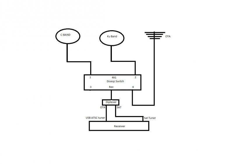

Hello Gents
I have some more questions, please take a look at this diagram on how to connect my dishes and OTA antenna, is it possible to connect them this way?, I been reading about diplexers and it may be to much insertion loss, or is there better diplexers that have low insertion loss that I can use or is there any other way I can connect my dishes and antenna, I want get rid of some cables inside the house.
Any Ideas would be appreciated.
Thanks in advance.
Regards
Chewie

Hello Gents
Thanks in advance.
Regards
Chewie
It will not work ... OTA tv is 200 Mhz to 800 Mhz and the DiseqC switch range is 950 Mhz to 2400 Mhz. Run a separate cable to the OTA tuner. Use a 22k switch if you have only 2 LNBs

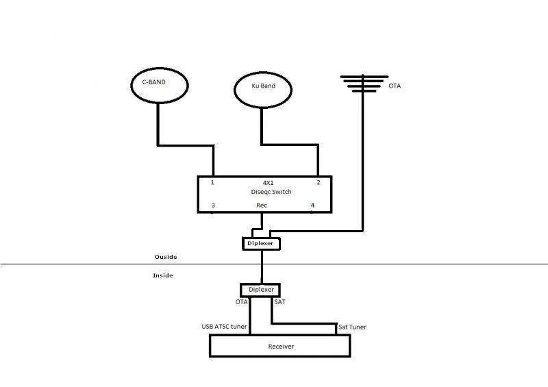

When you have problems running a second cable, it can still be done with one cable (with losses both on sat and on OTA!).
In that case you'd need a second diplexer at the output port of the (diseqc or other) switch.
So... a diplexer can be used to add OTA signal, and to split off OTA signal.

Thanks all of you for this information I will give a shot and see how it works .
Regards.
Chewie
