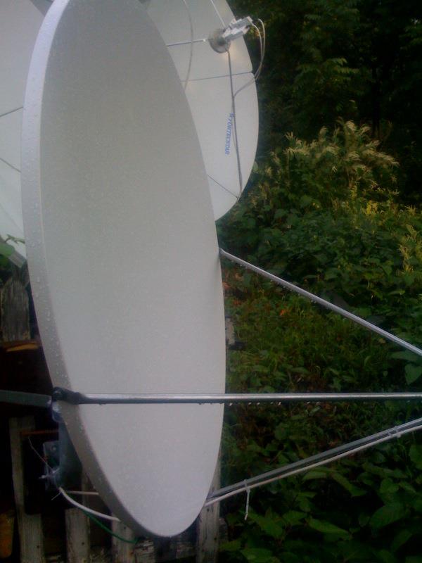

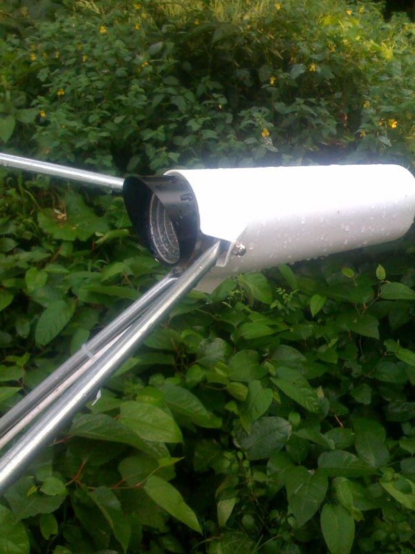

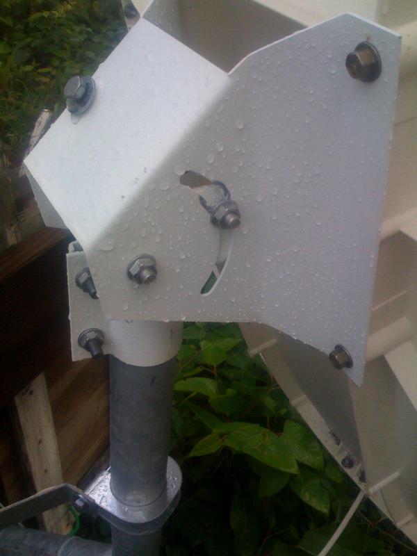

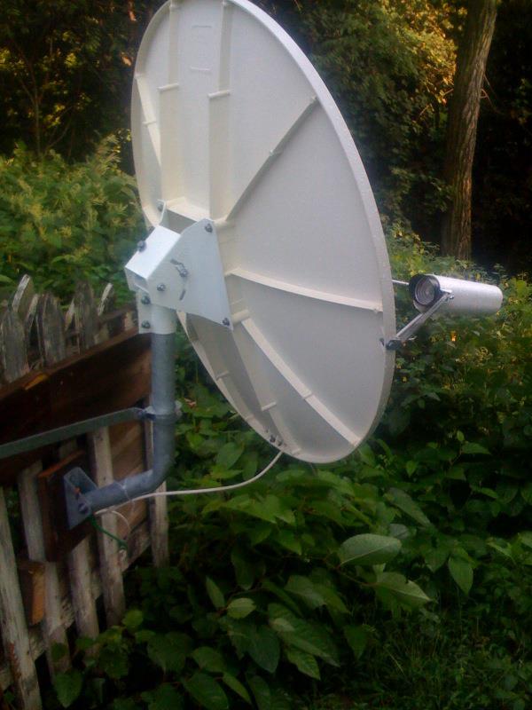

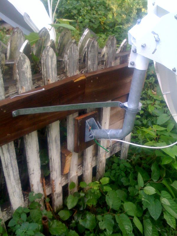

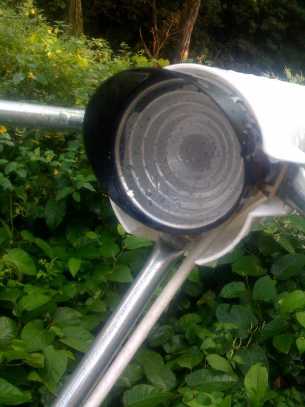

Two years or so ago I got a 90cm Prodelin offset dish antenna for Ku reception. It is built like a tank and works way better than any of those crappy Fortec Star or similar offset dishes. If you have any of those, just throw them away like I did mine. It cost me almost $300, and I think $60 or $70 for the dual polarity kit, but it is well worth the money. It's the most stable and rock solid dish I've ever used. It's a commercial dish of course, but for the constant good signal it suppies, it's well worth the money. A Zinwell Ku LNB was sold with it, which work really well and are really stable, they are typically used for Muzak services. Here are some pics of it where I had initially mounted it, on an old and wobbly wooden picket fence:

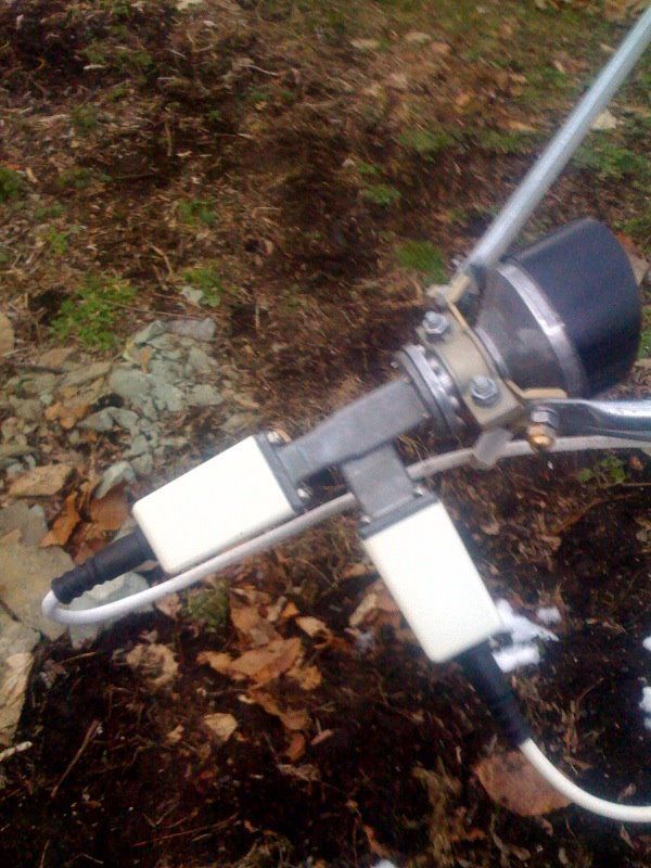

I bought it specifically for trouble-free reception of PBS's HD east and west feed on AMC 21. Other than the wobbly wooden picket fence, it provided very stable signal. Later I bought the dual polarity kit and another Zinwell LNB. This included a feedhorn that outputted both polarities (the single feed feedhorn only outputted one), a waveguide splitter, and used another Zinwell LNB:

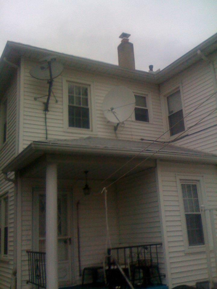

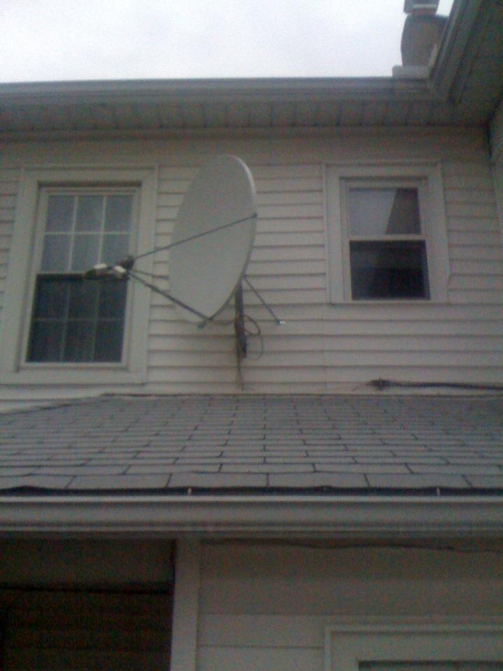

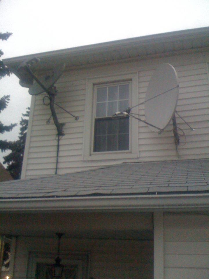

This was for horizontal reception as well, mainly because I wanted to mess around with some horizontal feeds. Because of the wobbly wooden picket fence, I decided to move it. The signal would be great after I first adjusted it, then gradually go to crap. So here are pics of it in it's new location, near my Directv dish:
303862_2576143961915_1203828635_3028076_3187097_n.jpg294638_2576145321949_1203828635_3028077_18374861_n.jpg317480_2576147281998_1203828635_3028078_1424412129_n.jpg

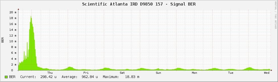

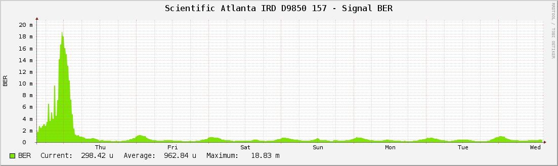

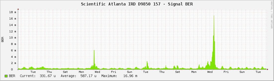

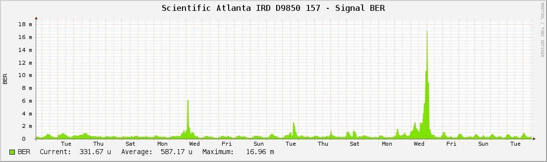

Now the signal is rock solid stable, and PBS HD east and west come in good and strong. Here is a graph of BER since the relocation for this past week and past two weeks:
333250_2863825553775_1203828635_3169446_807009064_o.jpg331903_2863825793781_1203828635_3169447_1831867157_o.jpg

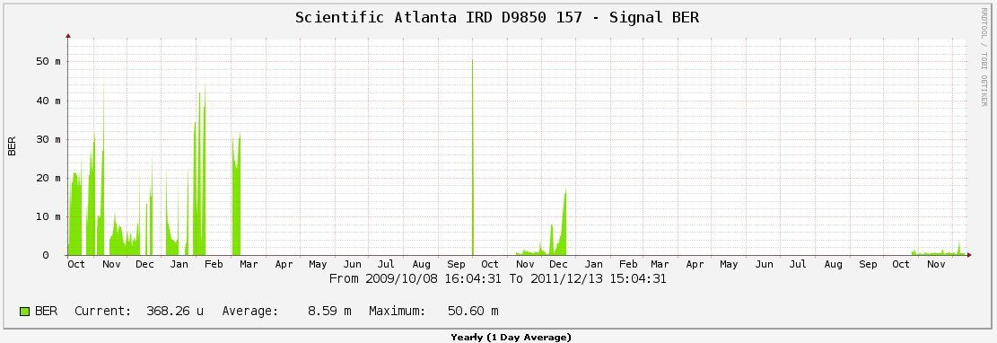

Here you can see the signal is much more stable with the exception of rain fade, which will be more prominant than Directv because the signals are not as strong as Directv. This past wednesday it rained heavy all day, so there was a lot of rain fade. Compare that to last year when I had it mounted on the wobbly wooden picket fence. In the latter half of the spring, all of summer, and early half of the fall, trees and Japanese Knotweed prevented any reception at all. I hated missing PBS during these times. Here is the unstable reception of it mounted on the wobbly wooden picket fence:
Towards the left of the graph is fall/winter of 2009. I had to adjust that wooden picket fence every few days then. After March, I could get nothing. I didn't mess with it much the fall/winter of 2010, which is in the middle of the graph. Towards the right of the graph is this fall when I relocated it.
I was just afraid to get on the roof and run the cable, but it paid off when I did finally relocate it.

Hopefully you do not get much snow!
Because of where it's pointed to (125W) and the dish is offset, it's almost 90 degrees so snow doesn't collect on it at all.

" the dual polarity kit and the Invacom LNB with waveguide input" also came from Prodelin direct? I have a couple of the same single polarity lnbs as in the photo and could certainly use the waveguide splitter Ts. Thanks
You can often find it or its siblings, the 1.2 meter and 1.8 meter versions, on the rooftops of closed gas stations and department stores. When they re-roof the business (or tear the building down), ask them to hold the dish for you. These, along with the Channel Master dishes, are excellent commercial dishes.
Unfortunately I couldn't obtain one this way. Plus you need to deal with missing parts on occasion too. These kinds of dishes typically contain BUCs as well because they are tx/rx dish antennas. Whether or not the BUCs transmit at the same or opposite polarity as the receiving signal, I really don't know. But I urge anyone, that if they can get their hands on one of these dish antennas, to definitely do it. Their performance and stability will absolutely blow away anything else.
You cannot get the Invacom LNB with the waveguide input from them, it's a consumer LNB, Prodelin doesn't deal with that. The reason I suggested it is because most of you use FTA receivers which use 13/18V polarity switching instead of running two feed lines with two seperate LNBs like I use. I run the feed lines to an active L band splitter and power inserter, then to commercial IRDs for my setup, while most of you use FTA receivers. The 1921 series dish antenna comes with it's own feedhorn, so it's not wise to use an LNBF unless it can connect directly to the feedhorn. It comes with a feedhorn for feeding only one polarity at a time, not both. For both polarities, you need the dual polarity kit which will come with a different feedhorn that has a larger opening and the waveguide splitter. The Invacom LNB is the only 13/18V polarity switching LNB with waveguide input that I know of, I think there are others. If you don't need 13/18V switching, Zinwell, Norsat, or Cal Amp Ku LNBs are like tanks! Perfect compliment to a good commercial dish antenna.
