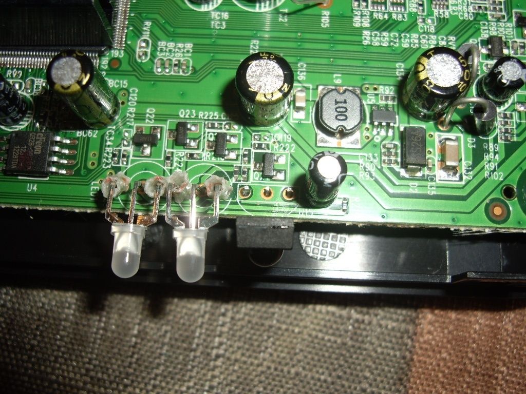

I have contacted the seller and have made arrangements for an exchange. However, because of your suggestion and the warranty will not be voided, I opened the unit to check the IR sensor placement and found that behind the IR sensor the center and R/H leads are not soldered(hard to see the no solder in the picture). I do not know if they need to be soldered or not. And if they do need to be soldered something else may have burned out.
I would solder them but these old eyes and trembling hands can't do small work anymore. I did replace the battery in my 4DTV but that was like working on a tank compared to MicroHD.

Agreed. From this angle, the leads appear to be solder-free on the top of the board. If so, certainly could be a manufacturing defect. Hard to tell with only this photo. To determine if the component is properly installed, the PCB would need to be lifted from the chassis to view the other side of the board where the receptor is mounted.
I don't recommend continued disassembly as soldering would void the warranty.
We are here to assist if you have any problems with having the unit replaced. Sorry about this problem!
I took apart my microHD.
The IR sensor solder joints looked same as yours from above.
Removing two silver screws permits the PC board to be removed.
On the bottom, the three leads were soldered reliably.
I would bet all units look this way; which is fine. :up
Best to return it and have it checked and fixed properly. Could be the IR receiver and not just a bad solder joint.
