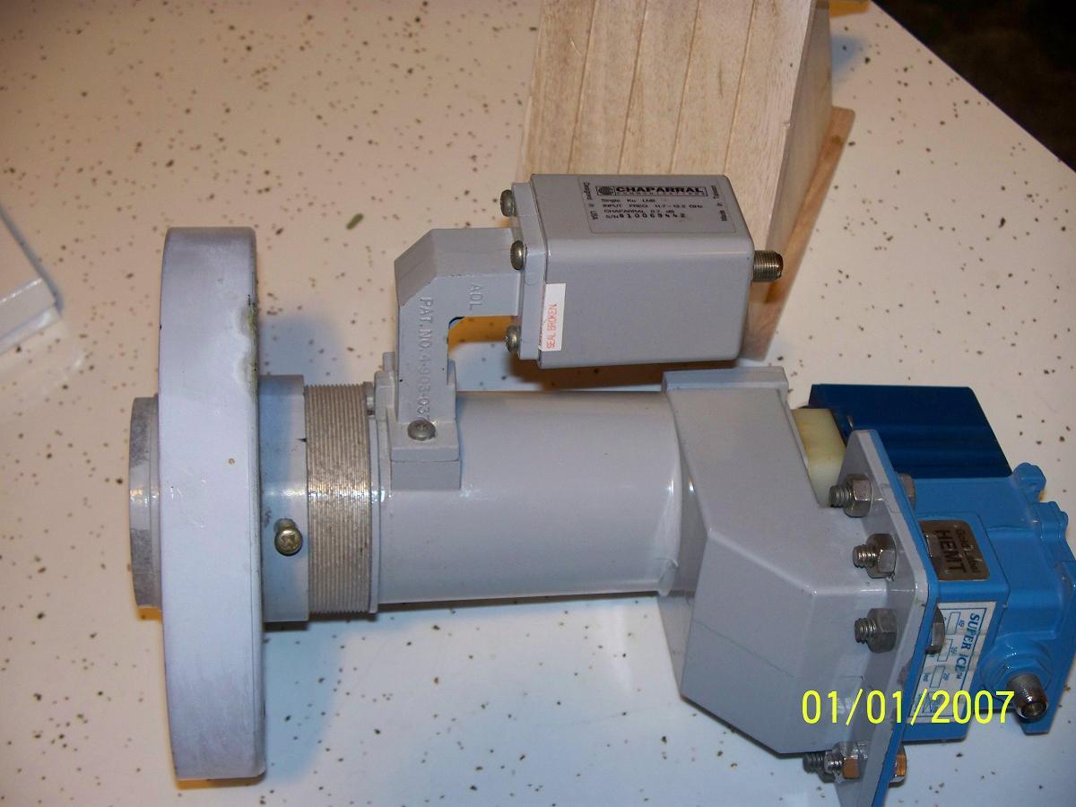

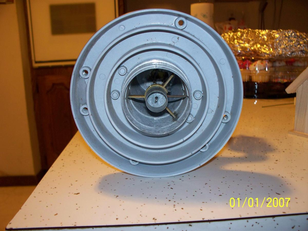

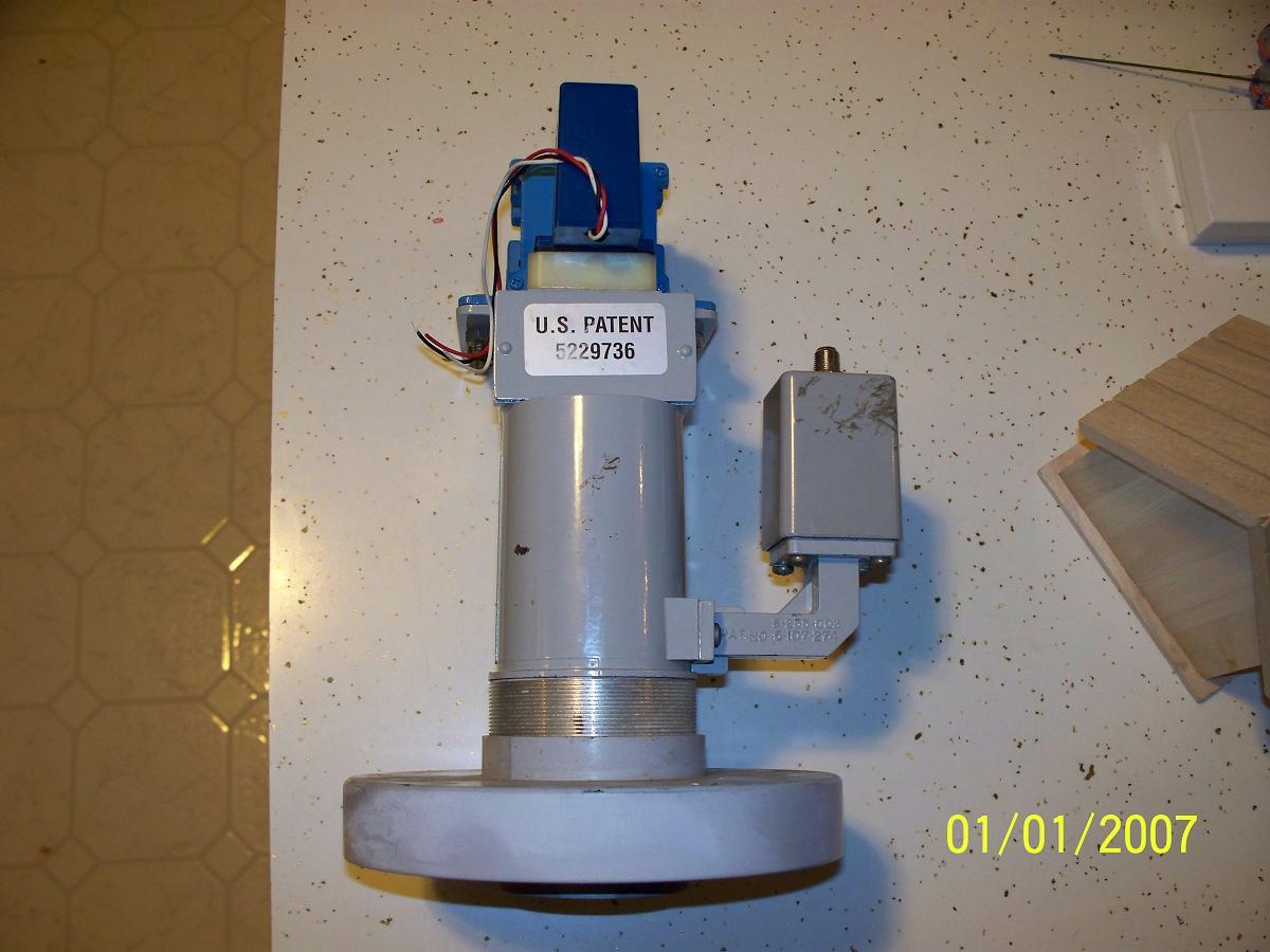

I found a adl feedhorn for $30.00 and would like the know some info.
First what way do you mount this feed, It will be replacing my combo 741 lnbf.
Second there are no marks for f/d,so should I just use the old tape measure.

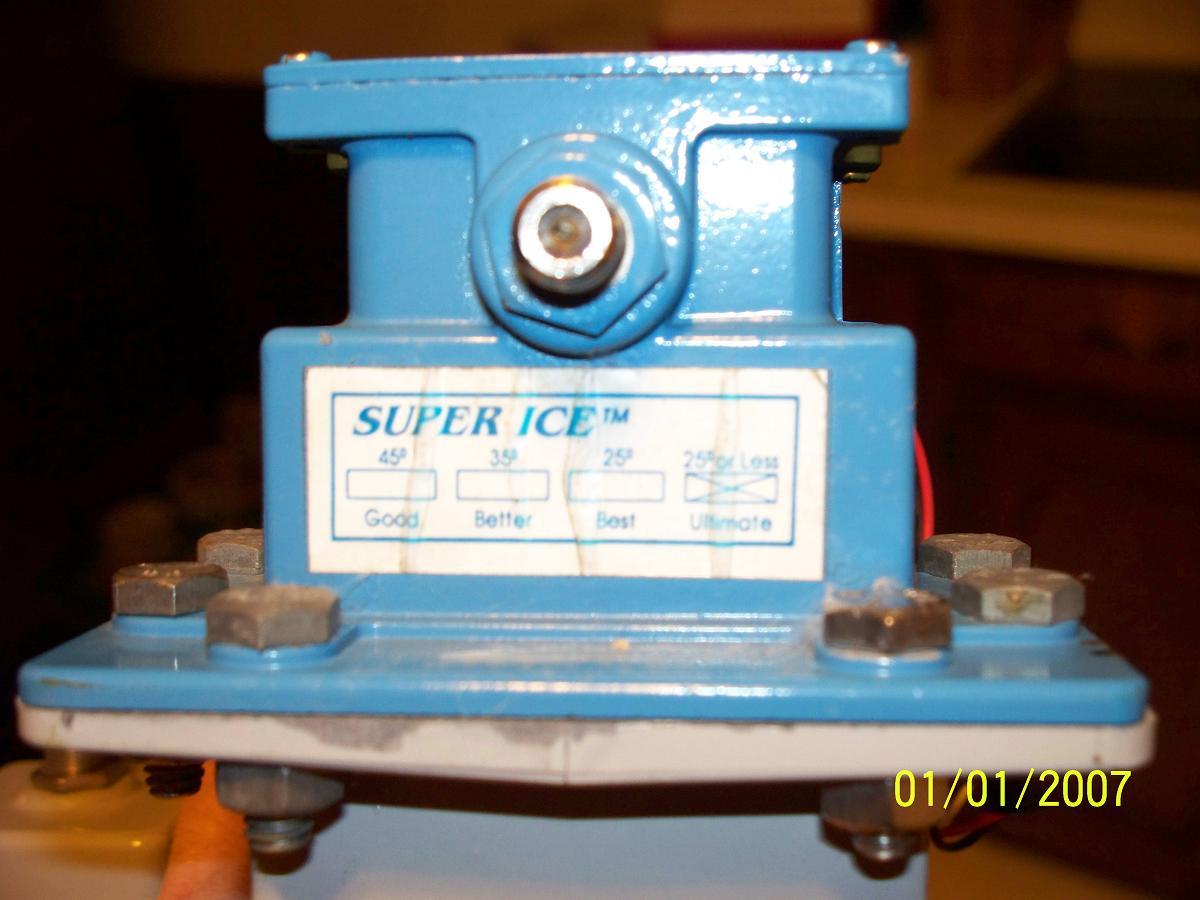

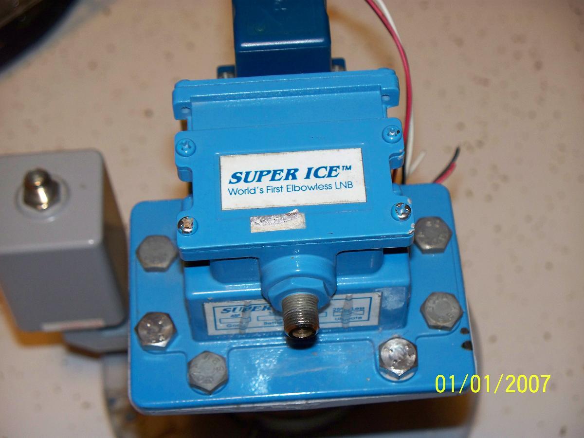

Third Is this c-band lnb a good brand ?
Forth do we have a manual for this type of feedhorn or does anyone have the
manual. Here are some pics to enjoy. Thanks

The feed is an ADL RP3 C-KU it's almost like a Chaparral. So you can follow there installation info. The LNB is a Super Ice (Rice Burner junk) that was sold on Satellite city. I would get another LNB and use it with the feed. It may not work well with digital.

"Worlds first elbowless lnb" gotta love it:D Gary (Satellite City) talked me into buying one and it turned out to be a nice Cal-Amp 30 degree so I wouldn't throw it out unless I gave it a try. Its not a Cal-Amp for sure but it might work ok provided lightning didn't get it over the years. BTW, you did ok for the $$, the ADLs are nice feedhorns, I have an RP1
