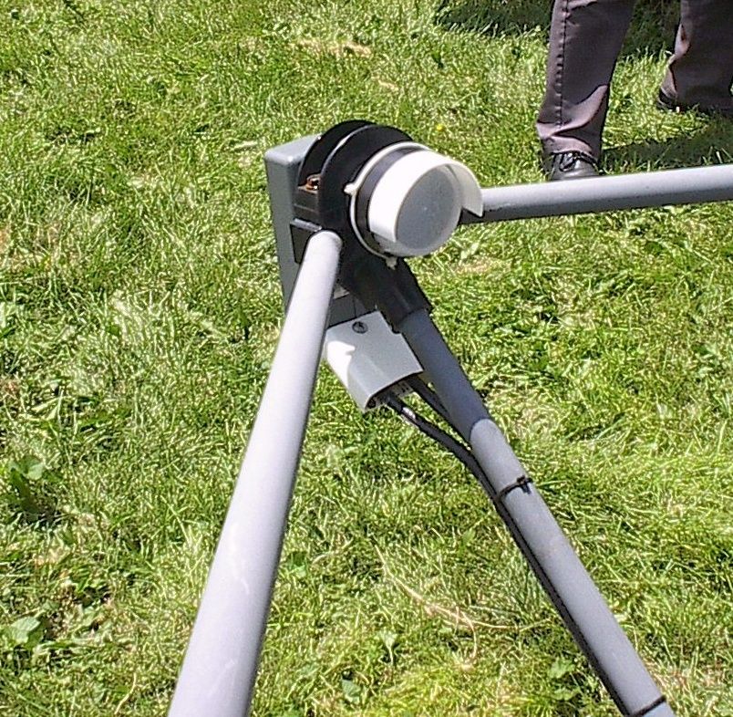

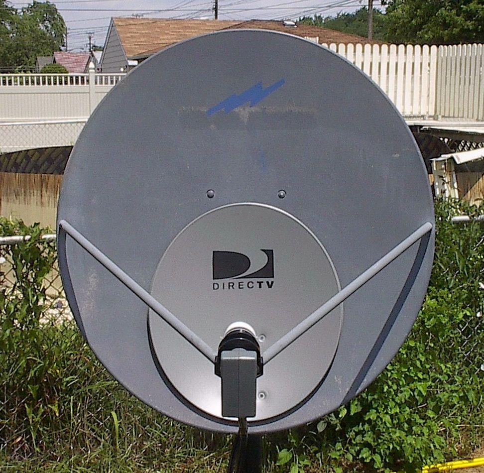

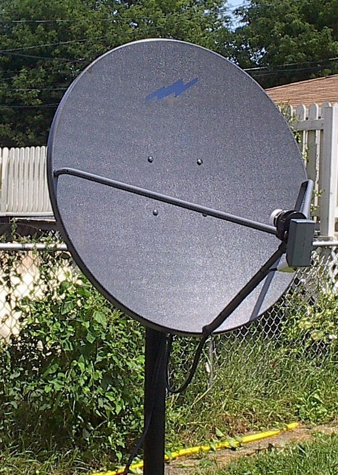

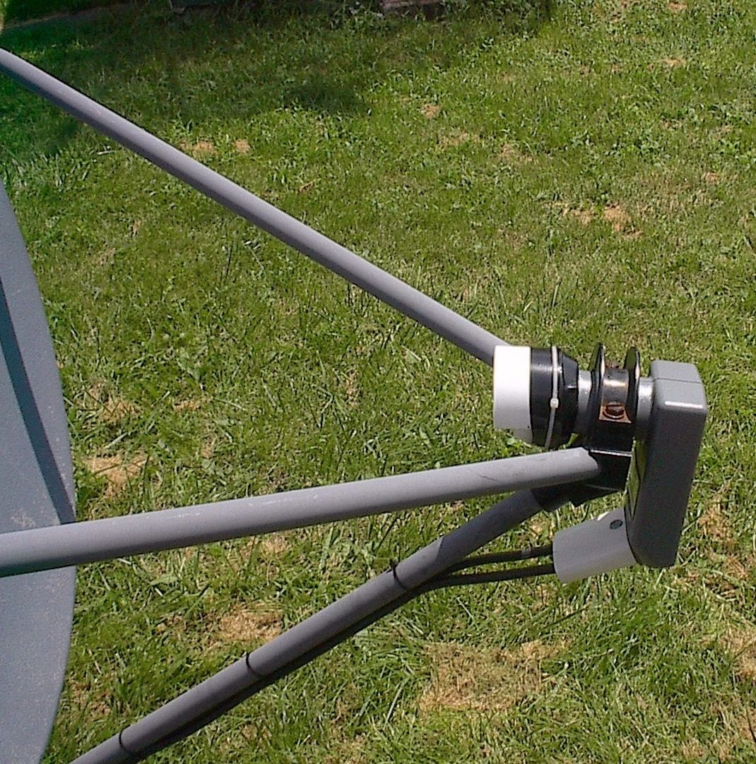

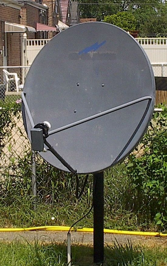

Today I converted my 39 x 36" Primestar 90cm dish for DirecTV 101. This has to be the ultimate rain fade solution. I was doing reading on commercial installs. The numbers went up on all transponders over the Slimline. Now to see what happens in the rain.
I included a couple pictures of the moded Primestar and a pdf file I found on commercial installs. See pages 6 and 7 about rain fade and dish sizes.
If you look at picture 2 you can see how much larger a 90cm is than an 18"

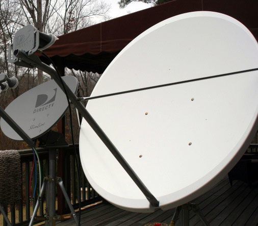

This is Direct's 1.2 meter for Alaska and Hawaii. From what I understand it's a Prodelin dish. With a pipe at the feed for Skewing the tri lnbf.

Here are some pictures of the feed and such. I bet I could modify it to take a SLM 3 LNBF like the direct 1.2 takes.
