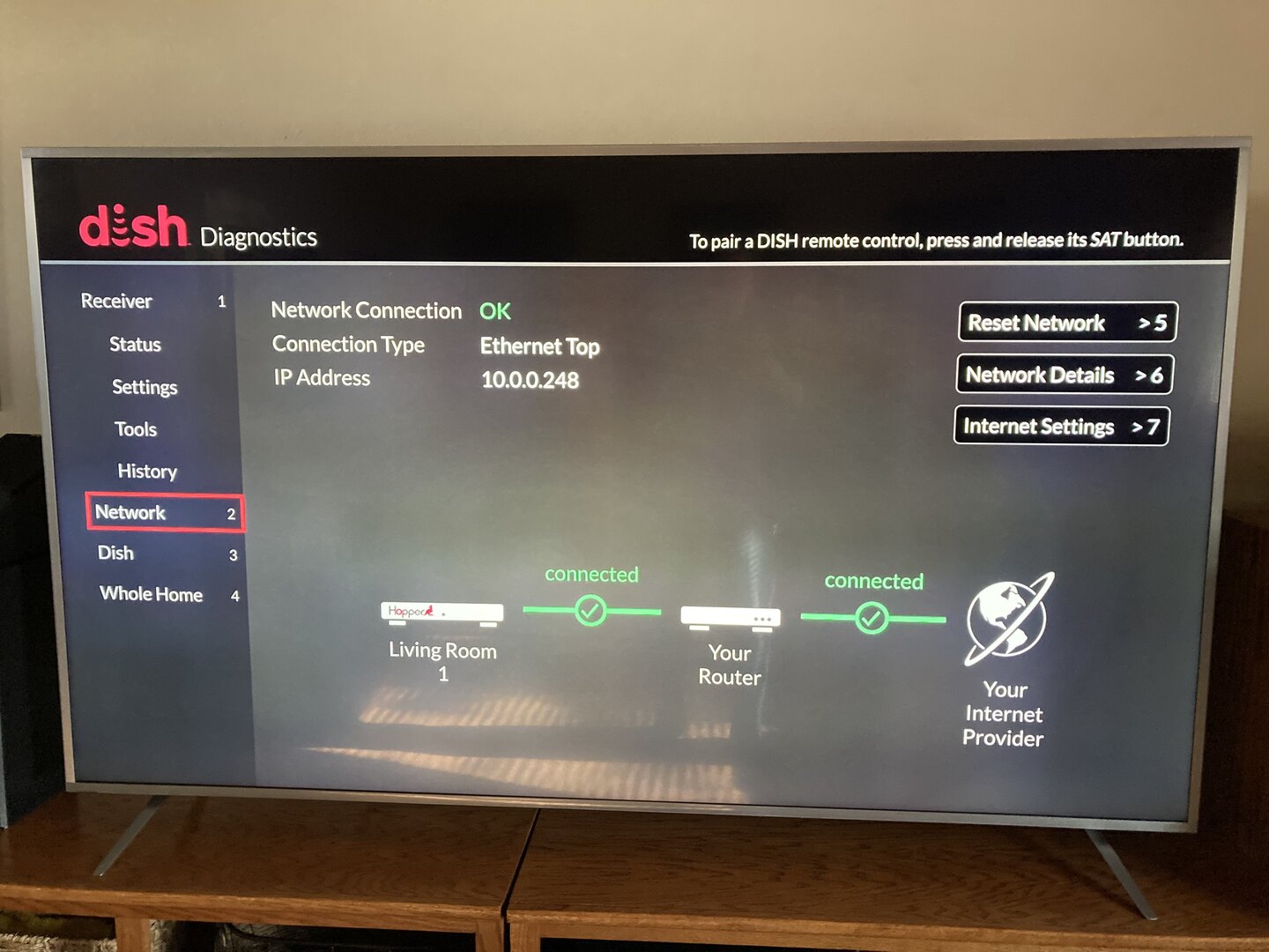

Just for jeepers, Web, what does your Network look like on the Hopper. To see this, press Home 3 times on your remote and then go down to Network or press 2. You should get a screen that looks something like this:
If you don't see a 'connected' between your Hopper and router press 5 to Reset Network. Try this and see what happens. Also if you can please take a picture of the Diagnostics screen and post it here.

Example: In my screen shot 192.168.5.238 is my Amazon Fire TV.
See that every device starts with 192.168.5.XXX. The XXX being unique.
You may see the addresses as 192.168.1.XXX or as you see in Bobby's screen shot......
HIS home network is 10.0.0.XXX. His XXX number for his receiver is 248. His pc may get 10.0.0.50, printer may get 10.0.0.61.
Those numbers are assigned BY HIS ROUTER. IF THEY ARE SET TO GET AN IP ADDRESS Automatically.
Please grab a screen shot(s) of what you currently have. And post them.
