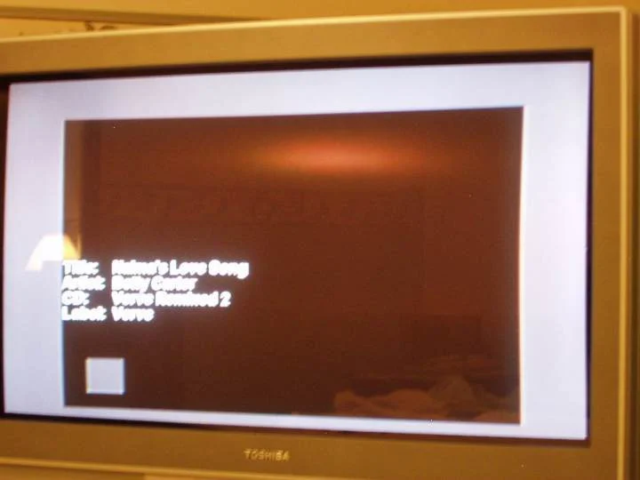

Well, I ran across an interesting "feature" of P266: I was watching an SD channel, with the stretch mode set to "Gray Bar", and after the program was over, I switched to one of the CD channels. The screen went gray, then cleared a black box in the center. When the channel banner went away, the music information showed up, but with gray bars on both sides, top, and bottom.
It's easy to recreate; tune to a CD channel and use the "*" key to move through the modes. When you get to Gray, stop and watch the weirdness. As the text gets to the bottom, the block starts to blink and change size. 30 years after Atari, Dish has created HD Pong!

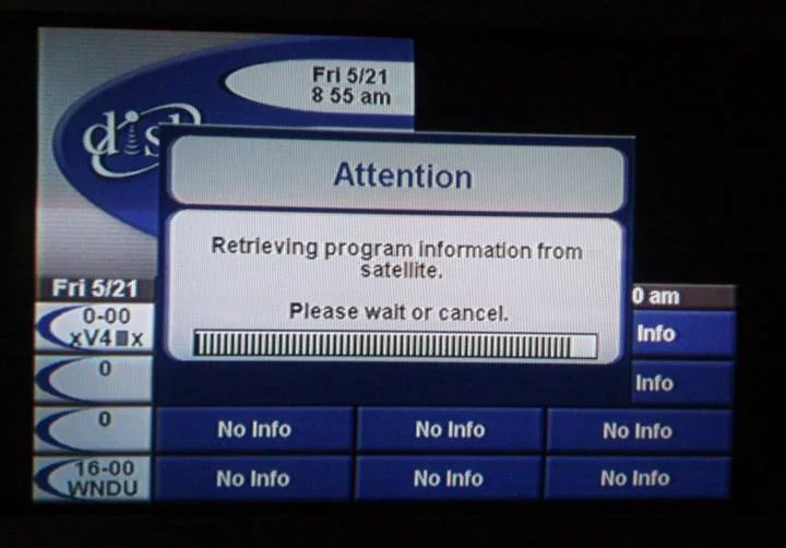

GaryPen said:
Plus, when the "downloading guide" box pops up, the guide has garbage characters.
GaryPen, I noticed this in P265, which was the first version I ever saw, since I got my 811 right after P265 spooled. I've attached a picture of my Guide in Confused Mode.
Also, has anyone noticed that after making changes to locals, if you go straight to the EPG, or immediately after downloading guide info while the guide is open, it will show multiple instances of your digital OTA channels?
Personally, I wish it would do that normally, instead of showing only one channel, and then giving you the sub-channels AFTER you click on it.
This also would/does happen on the 6000 from time to time. And I agree, it would be nice to one-button select an OTA ATSC channel.
I've also noticed that if you trigger the Guide Download while watching an ATSC channel (in my example, 22-01) that has multiple sub-channels (22-01 through 22-03), after the Guide redisplays, the ATSC tuner is now tuned to the highest sub-channel (22-03). Fastest way to trigger the Guide Download is watch OTA for an hour, press "guide", punch in "4", "8", and ">" to go 48 hours forward in the Guide.
