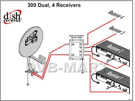

I'm sorry maybe I didn't type that right,, I have one Dish 500 with the dual lnb, one is for 110 and the other is for 119. Your correct on the SW24, I have the 110 ouput cable plugged into one input of the sw24 and the 119 in the other. I then hooked one receiver cable into the receiver 1 output and the second in receiver 2 output, leaving output 3 and 3 empty. I'd get another SW21 but Im not sure how would split the signal out of the lnb's??
Ok, gary you confused me,, here's what I have, so tell me, does this not work? See the attached image..

Sorry, must have confused with a SW42 switch. Uses two separate legacy lnb's with two lines from each lnb to inputs on the switch and only two outputs to receivers. That looks more like a splitter and not a switch, you run two lines from one lnb and you get four lines from the one lnb. Think you may have the wrong equipment.

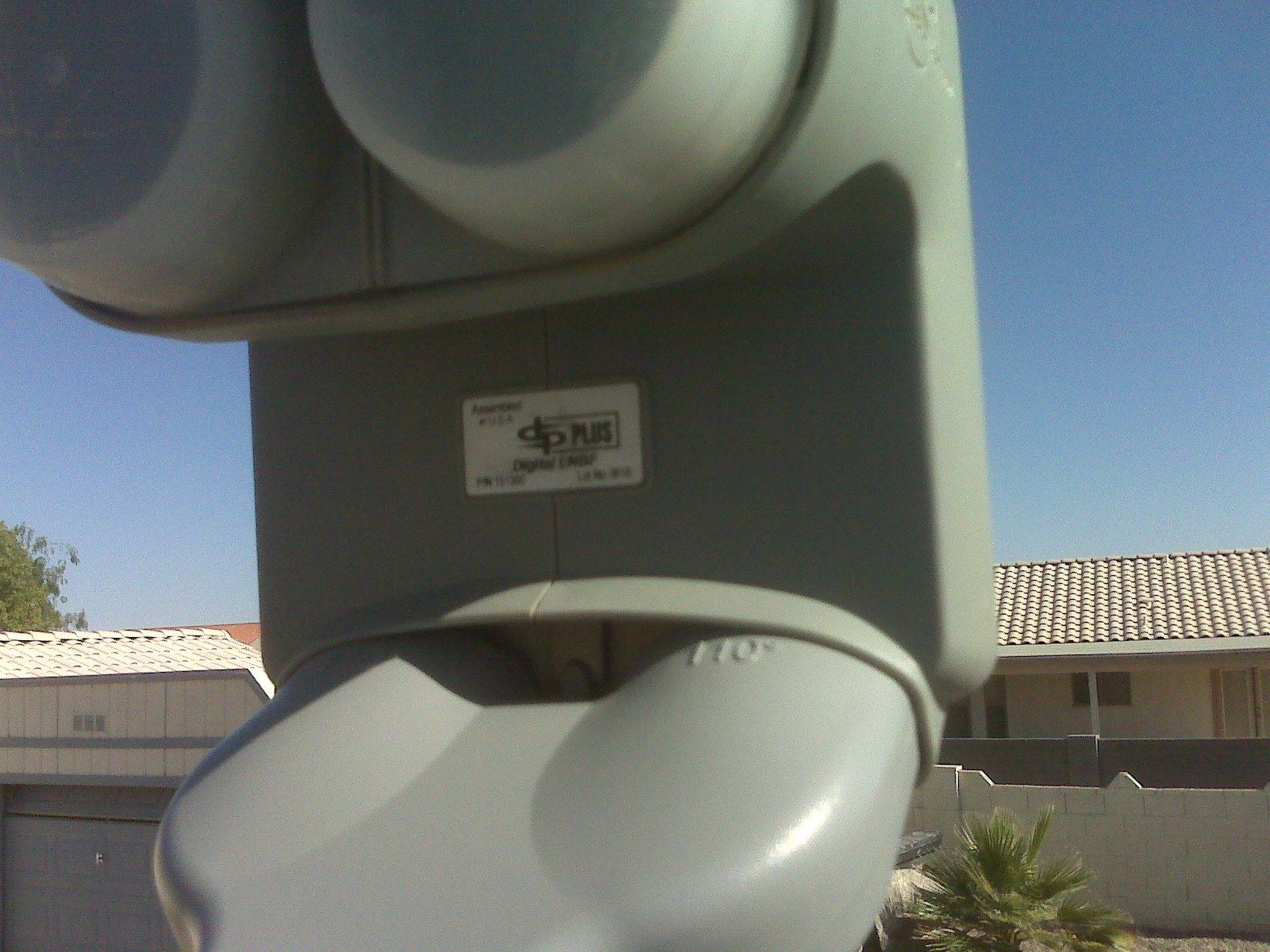

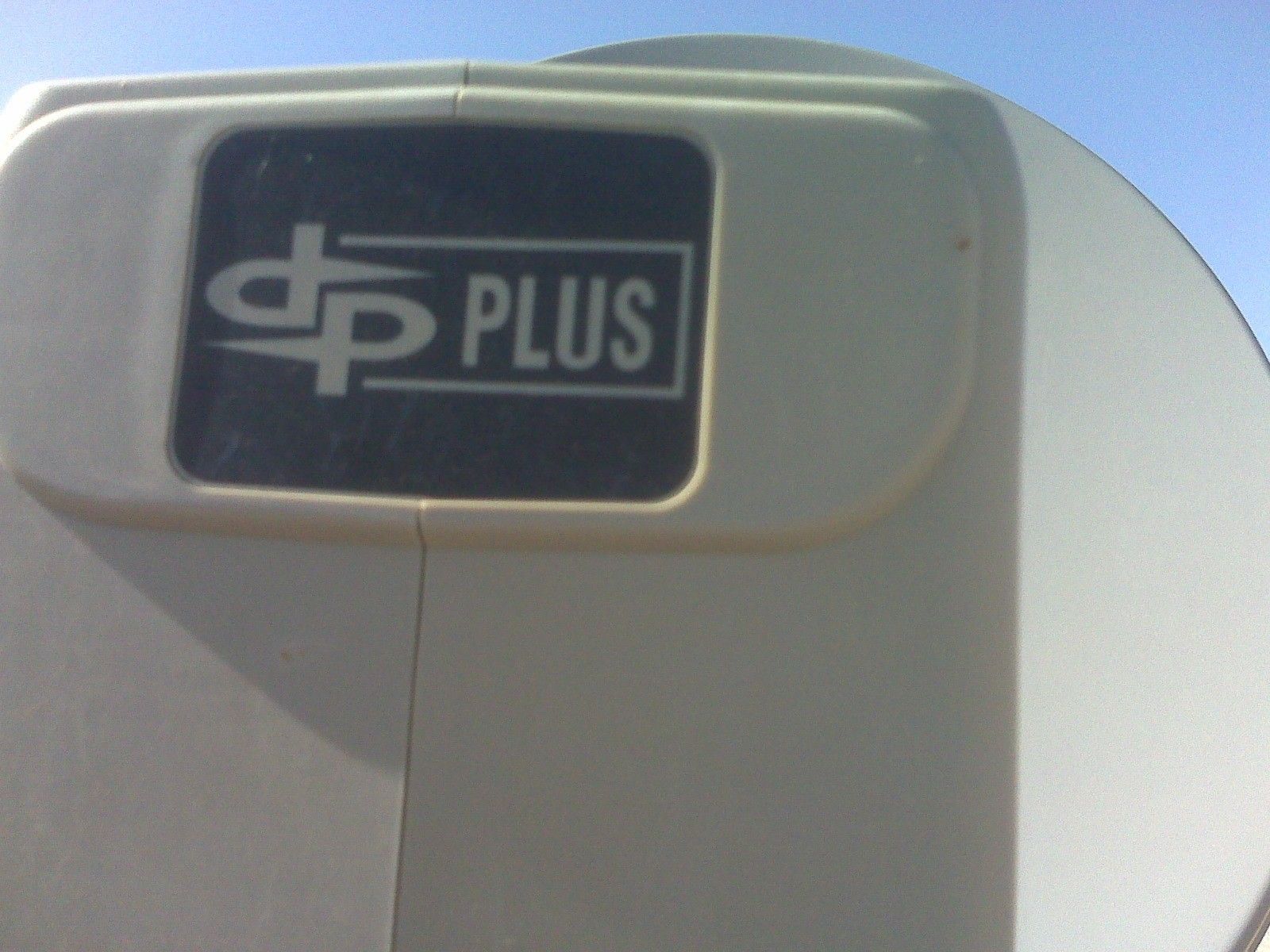

Now last question - is your 'dual' but in reality TWIN LNBF is one block or two separate LNBFs ? How many outputs there ? What logo on it ? DP or not ?
Hey guys, sorry for not responding earlier, I've been out of town. Attached are pictures of the dish. It has only 1 output for each signal (119 and 110). What do I need to do to get to tv's running on the dish? Is there a switch that does work, or do I need to preplace the dish entirely?
those #'s are for if your using a switch - with the DPP lnb just connect one receiver to one output at the lnb and connect the other receiver to the other output at the lnb then redo your check switch at each receiver then your good to go - don't connect anything to the lnb in connection at the lnb that's for another wing dish
If I connect the receiver directly to one of the outputs, all I get is that specific satellite, either 110 or 119. The receivers are old models (2700's) so that maybe my problem. I'm trying to get them to work with that satellite dish. I want to be able to get both satellites with the two receivers. Now the current setup is one receiver connected to a SW21 switch to get both satellites. What type of switch do I need to get both receivers up and running?
Quick question, what model would not be considered legacy? Maybe I should just get some newer receivers?
with the dpp dish and legacy receivers you would have to have legacy adapters for them to work - what i would do is just upgrade your receivers to the newer dp technology - DP receivers are the models 3xx - 301 and above, 5xx - 501 and above, 921, 942, newer mpeg4 models are 211, 222, 622, 612, 722
With a DPP LNBF, it should emulate a SW64 for the legacy receiver, with a single cable directly from the LNBF (either port) to the receiver.
Connect it that way, run check switch again, it should show as a SW64 connected to 119, 110 and nothing.
