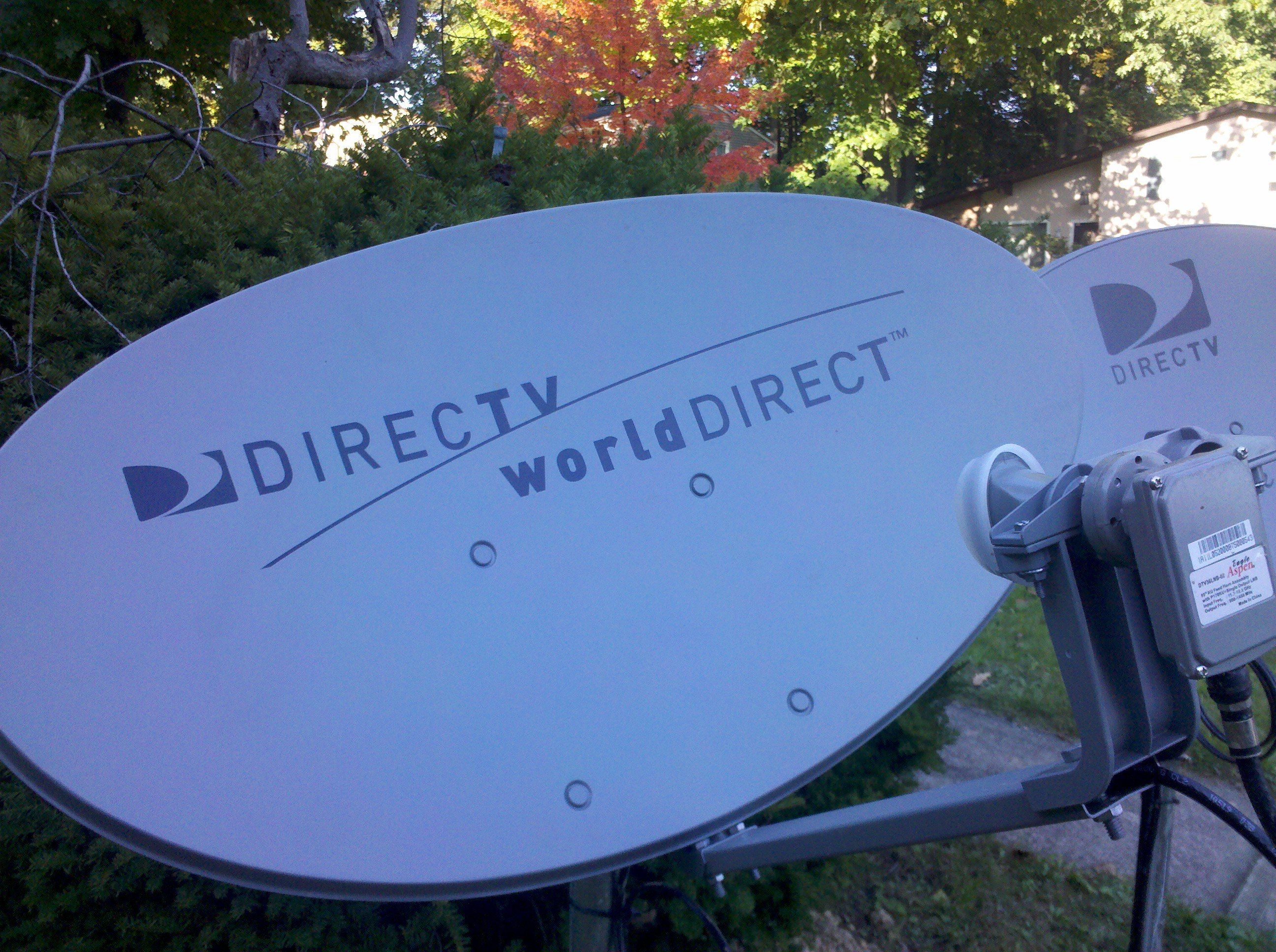

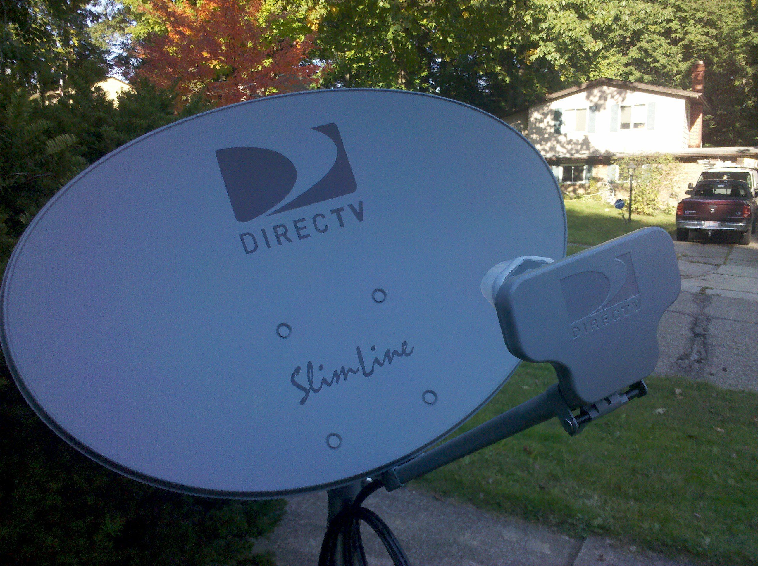

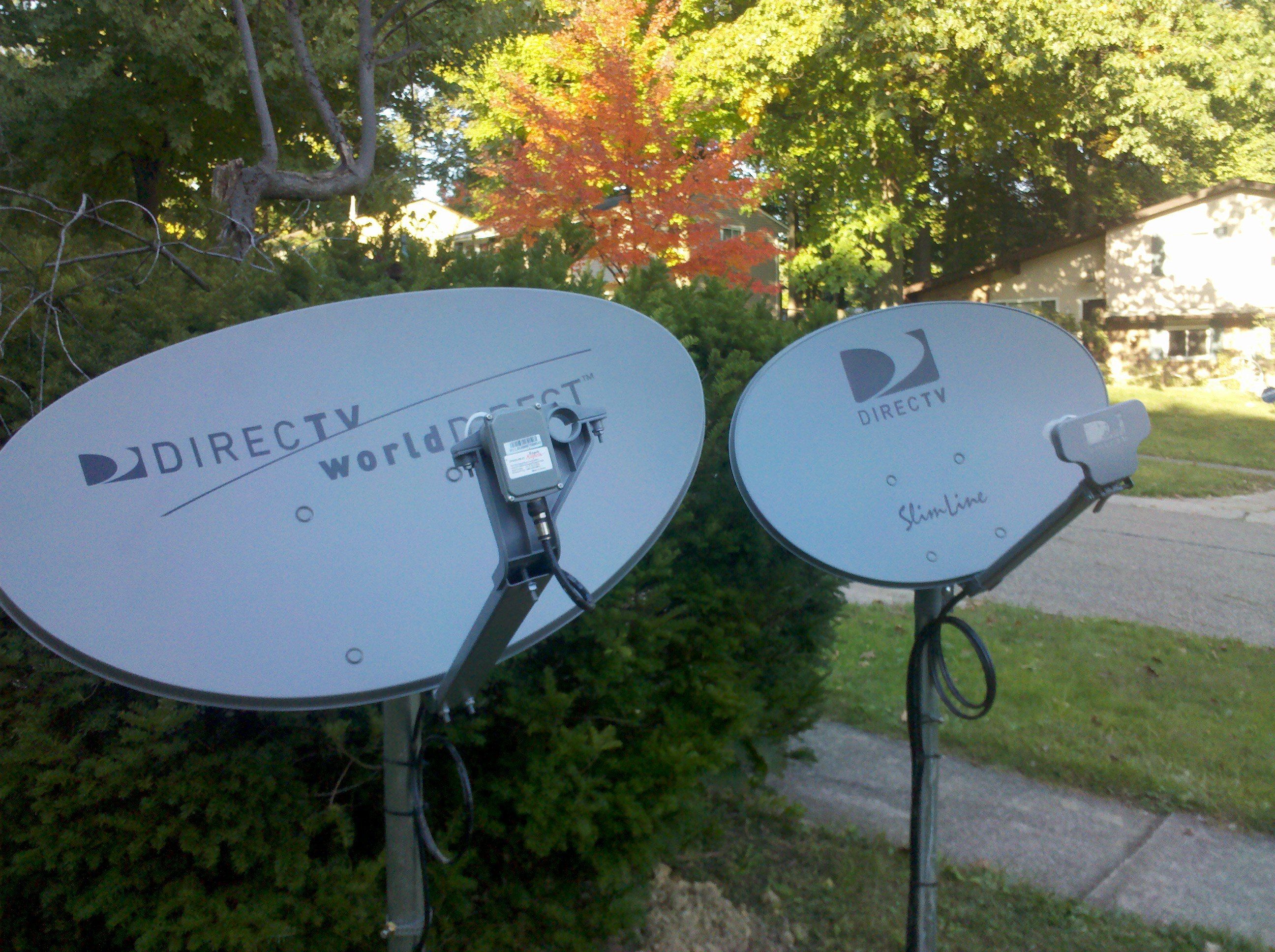

This is what i have:
you need the DirecTV AU9-SL3 to get 99, 101, 103 slots AND DirecTV WorldDirect DTVP36EDS to get the 95 slot
Note: The AU9-SL3 is an HD slimline dish.
I'll send some photos when i get home from work today.
Mike

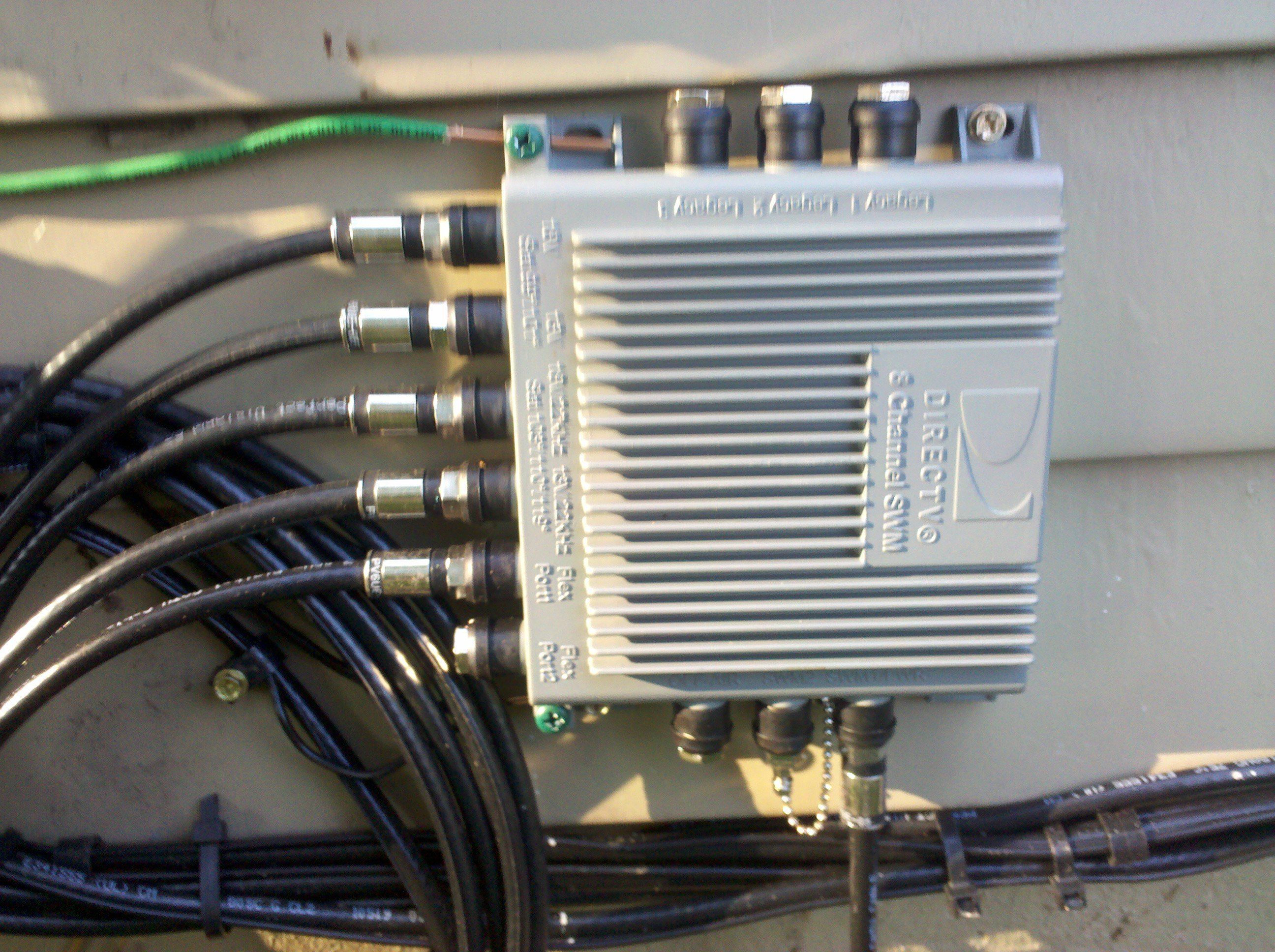

Just a few photos of my International and HD setup.

Looks like they did a great job on the install
Thanks Iceberg. Yes they did a fantastic job. Both inside and outside.
They buried the cables outside from the dishes to the house.
On the inside they fished ALL cables to both 52 inch plasmas (One in the finished basement and the other in the front living room) in the walls with outlets at both locations.
The best part is it didn't cost me a dime for the install.
Just a modest tip.
Mike
