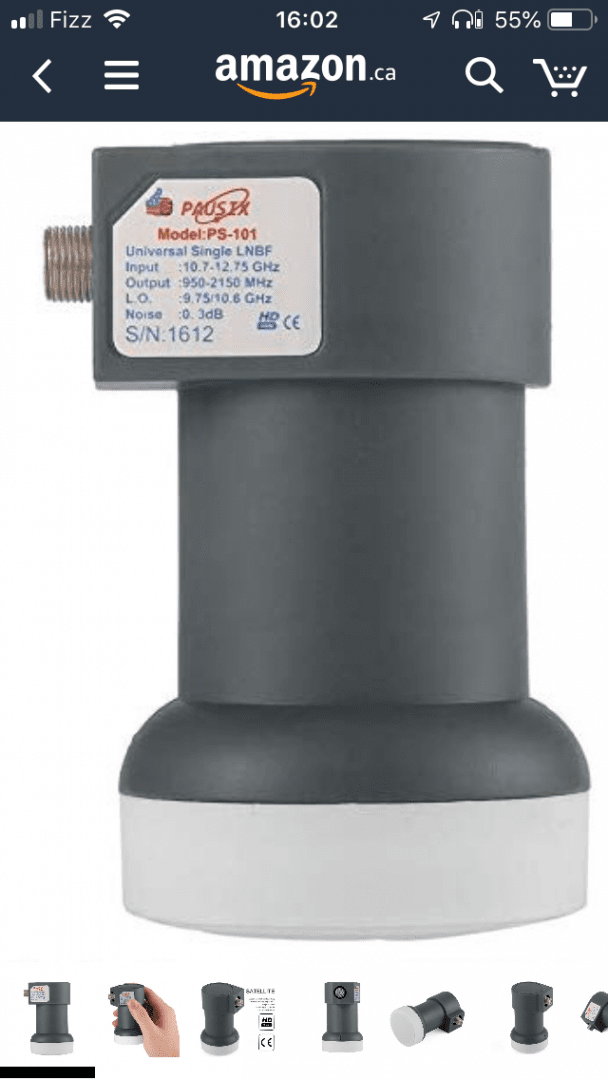

I'm using this universal lnb right now and i get about 5% more quality then the invacom.
A standard lnb has a L.O. Of 10750
Dbs uses 11250.
TP means TransPonder. (The frequency on which the channels are being transmitted).
If you have a box full of lnb's try to look for one that has the lowest noise figure. On the picture , it states 0.3db
The lower the figure, the best results you should have!

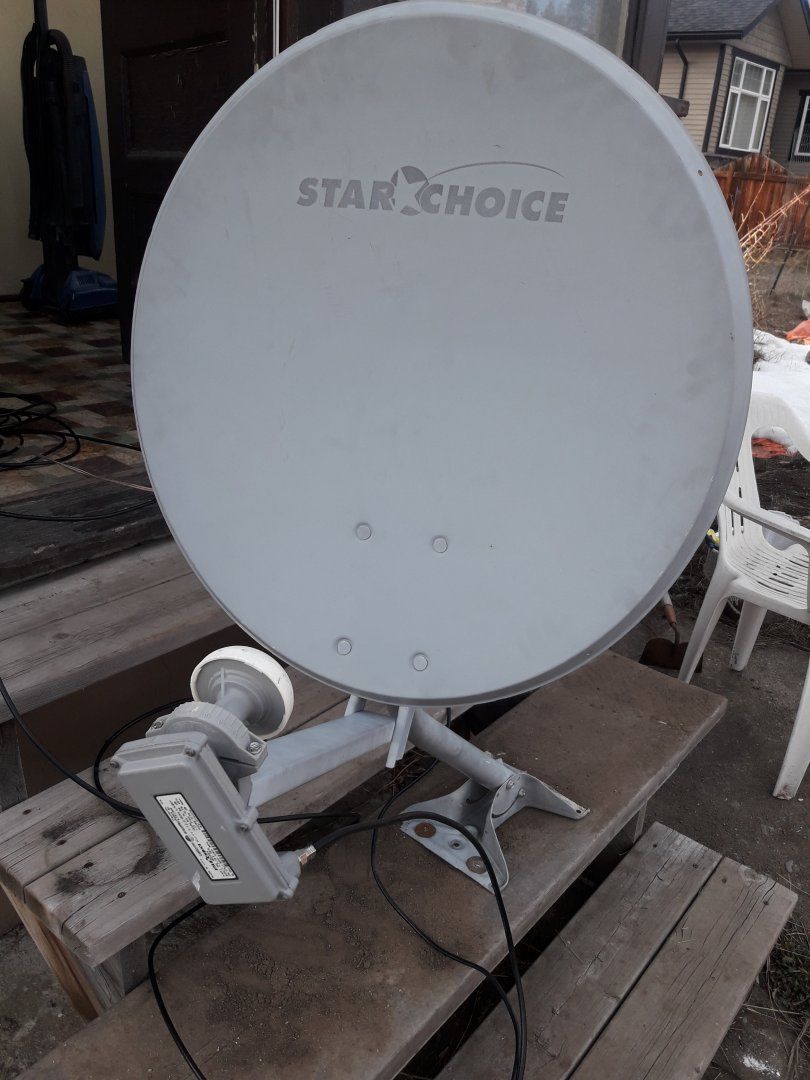

Thanks both u guys for all the help. Using those serttings and ideas i managed to get galaxy 19 today. Although not a very high Q. But its working and i can view the channels. I could not end up using one of the invacom lnb because i could not get them to mount on the dish. I need a different collar or something. So is this the only sat i will get with my receiver or are there others i should try? Also how do i know how far in the lnb should be in. Like how close to the dish it should be? I know the skew is turning it left or right but not sure how close to dish it should be. Here is a pic of the dish but i have 3 others i could try too.
I also have the same model! But the old star choice dish is the model that brings in the least signal.
You may have to build a homemade bracket or buy one from ebay in order to mount the invacom lnb.
You can try anything that is dvb-s non-hd mpeg 2 with your receiver. 97w has the most fta channels on 1 sat.
you can try abc newsone on 91w
Cgtn on 95w
A few c band channels if you have the proper size dish.
