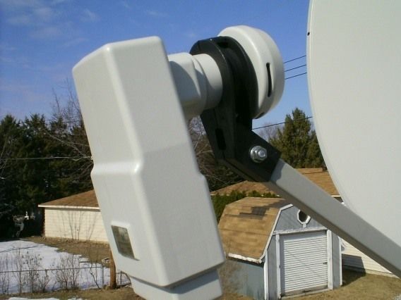

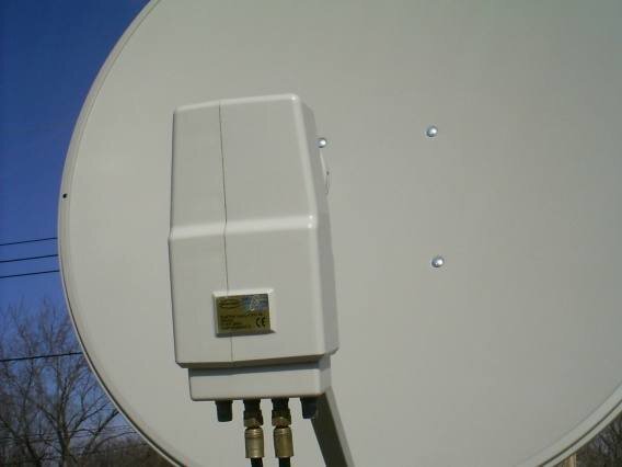

I am about 2 weeks old to this FTA thing and so far it has been quite challenging! I was doing great with the Fortec Star Single KU Band Universal LNBF till I got my Invacaom QPH-031. I got all the FTA channels on the Fortec Star Single KU Band Universal LNBF and no scrambled channels when scanned FTA. Now I get all scrambled channels (Say's Scrambled On Screen) and few FTA channels and nothing else. The set up for the Invacaom QPH-031 is LO frequency
11250 for DBS Universal or 10600 22k on for FTA, is this right? Do you set all settings in the ANT setup screen for each satellite you want to scan or is it a one time thing for all satellites? The book is not clear on this, I have a Diseqc 2x1 Switch inline to with the Invacaom QPH-031. I can aim it at echo 61.5 to get the channels that are in the clear, I go there to see if it moves to a satellite I know where it is. I have set up Sky angel in the past so I aim at this bird for reference and to see if the motor is moving right. It moves here and is right but when I seem to move to another one it is wrong. I went to echo 119 and got Bell expressvu information channels in its place. Clearly, something is not right. I just want it to move to the right satellites when I move to them. Could my dish be off or not set up right? Any input would be great! Thanx for your help!!
