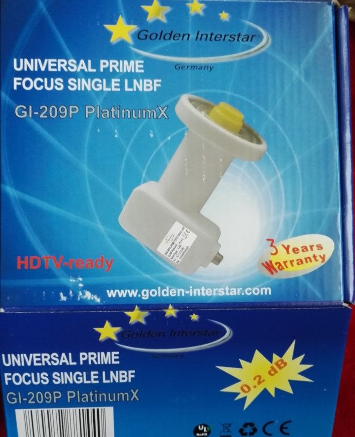

This side of the pond mostly GI-209P LNBs for PFA are used. They come in a set of star-bracket. Price is 10EUR. If somebody needs it, I could mail one. Shipping would probably cost another 10 EUR or so. IMG_20160728_125456 (Custom).jpg IMG_20160728_125524 (Custom).jpg
