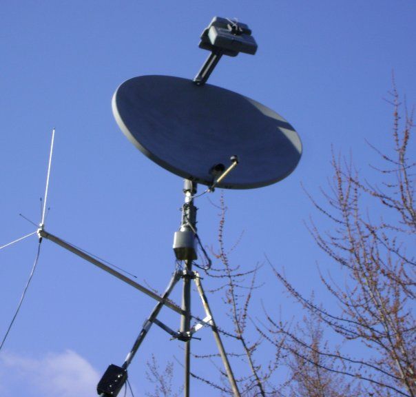

Used this old Primestar for years on WIFI. Flipped it upside down and got open WIFI a half mile away. Even put a compass and camera on it with an led to move it at night lol.

The Primestar dish will work if you want to use it. I was using it at one time to get GPTV on Ku with my 4Dtv and the lnb that the dish came with. I replaced the original lnb with an LNBF so it was easier to change polarity rather than using a separate switch. I had to fabricate a mount for the LNBF. The degree scale on the dish mount will be of little use. The GTMedia receiver is cheap but will work so you can see what you are able to receive.
