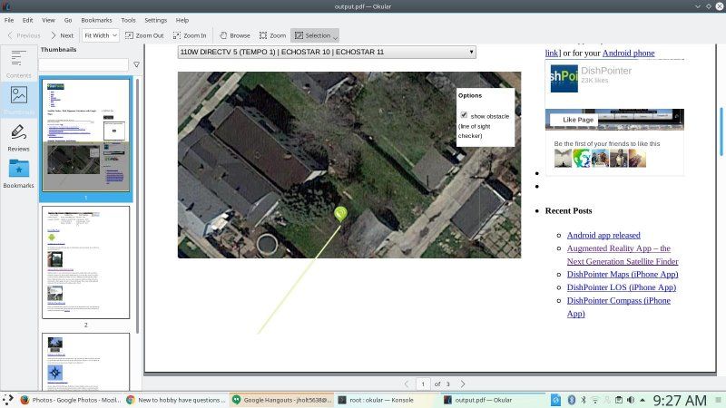

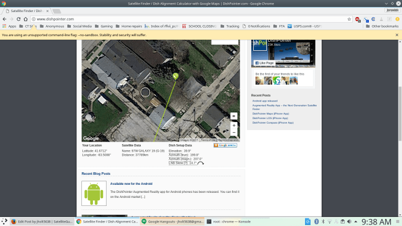

My sky is pretty limited here is a aerial picture of my yard and aprox position of the dish. Also how accurate is the line on the dish pointer?

At my location, I have found that the line is pretty close to being dead on. I will say that the image is a composite of several images, as the power poles cast a shadow one direction and the buildings cast a shadow another direction. (Just found it interesting.)
Took liberty of pretending to be at your location via dishpointer. Unless your neighbor's garage is considerably taller than I think it is, and you don't have branches hanging over your dish, you should be able to get 97W without any trouble. Remember that an offset dish is looking much higher in the sky than it looks like.
